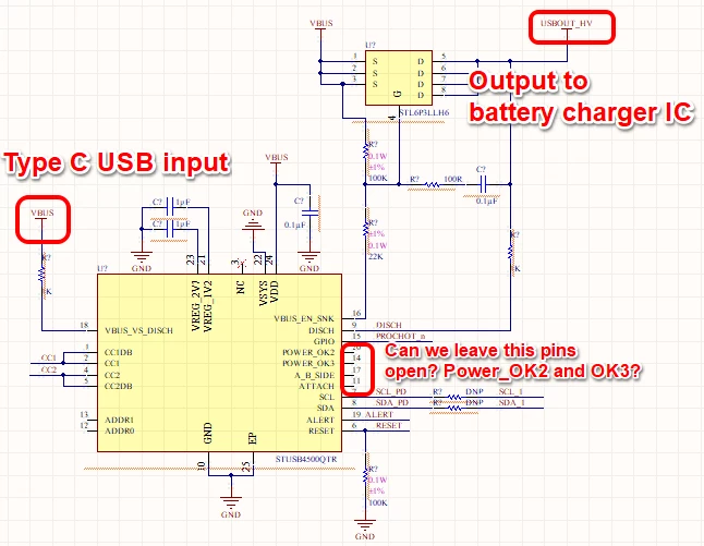

    0690X00000DXSIQQA5.pngHi Benoit FORET,
    Thank you so much for the reply. I would follow the EVAL-SCS001V1 reference design to draw an output of max 20v/5A. One final connection I would like to confirm is on the POWER_OKx pins can they be left floating as in image? So that it will not affect the output.
    Thanks again for your support.
    Regards,
    Sandeep G
    Feb 27, 2020 2:49 PM UTC
    ​Hi Sandeep,
    yes, these 4 pins are open drain outputs and can be left open if unused.
    Regards,
    Benoit
