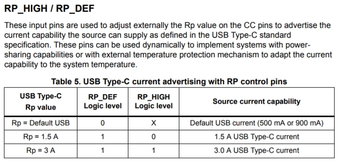

STUSB1700 For current 1.5A to 3A variation or lesser , can we still use 3.0A USB type C current source capability? OR Can we defining Rp_def logic level as 1 and Rp_HIgh also 1 for variable current from 500 mA to 3A? Thanks

    Yes, as it defines the source current capability. The actual current depends on the device being attached.
