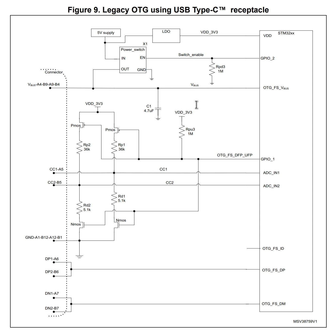

I'm trying to understand how I can use a USB Type-C connector together with the STM32MP1 USB OTG peripheral.
So obviously I want to use the port in dual role configuration. I want to use the STUSB1600 for that because it takes care of the power source/sink control for me. But I do wonder how should I connect the OTG_ID pin (if at all) in the STM32MP1, should it be to the ATTACH pin of the STUSB1600? The eval and DK only use the micro connectors for OTG.
I have found AN4775 and figure 9 (attached) explains how to use Type-C with OTG, but I'm not sure if that applies with the STUSB1600 because it takes care of the CC pins for me.
So if someone could please help with figuring out dual role with Type-C connector, please.

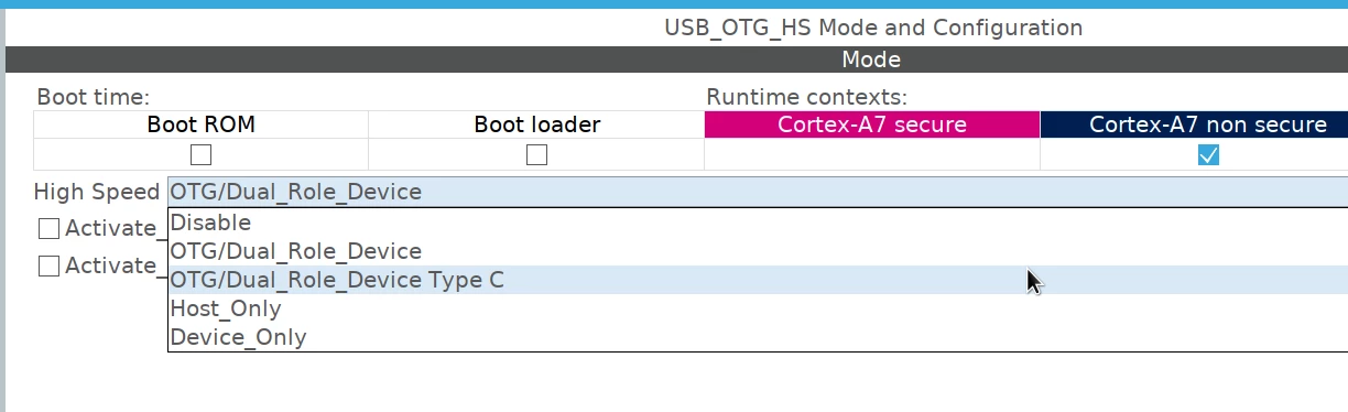

To add to the confusion, I noticed in CubeMX there are 2 options for setting up the OTG peripheral and the one that says "Type C" disables the ID pin :persevering_face:

Mar 14, 2019 10:48 AM UTC
By USB standard, OTG protocols are not supported over USB Type-C connector, so STM32MP1 ID pin is useless and VBUS pin management is handled by STUSB1600.
Type-C DRD (Dual Role Data) could be stated as the OTG equivalence when using Type-C connector. See usb.org or wikipedia for some general information.
Please have a look to STM32MP157C-DK2 board schematics (page 6) for an example of connection of STM32MP1 OTG IP with STUSB1600 supporting DRD/DRP (although power sink is open in that example as we supply the board 5V from another connector).

The USB OTG is being replaced by USB Type-C Dual-Role capability.
  • The ID pin (on the USB Micro-B connector) doesn’t exist on the USB Type-C connector, so the ID pin cannot be used to select the USB OTG as UFP or DFP.
  • It is now the CC pin which determine the Power Role and the initial Data Role.
Pull-up resistor on CC pin --> The application is Power Source & Data Host (DFP).
Pull-down resistor on CC pin --> The application is Power Sink & Data Device (UFP).
