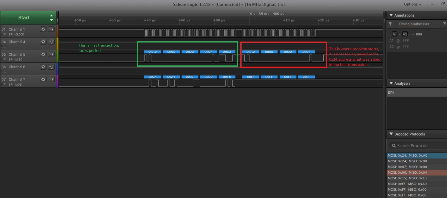

I am using STM32L34 with STPM34, where I am trying to disable CRC once the power up sequence is done ( global reset),but STPM34 chip always sends row 0 values. can anyone tell me what could be the issue? I am also attaching SPI bus data.
