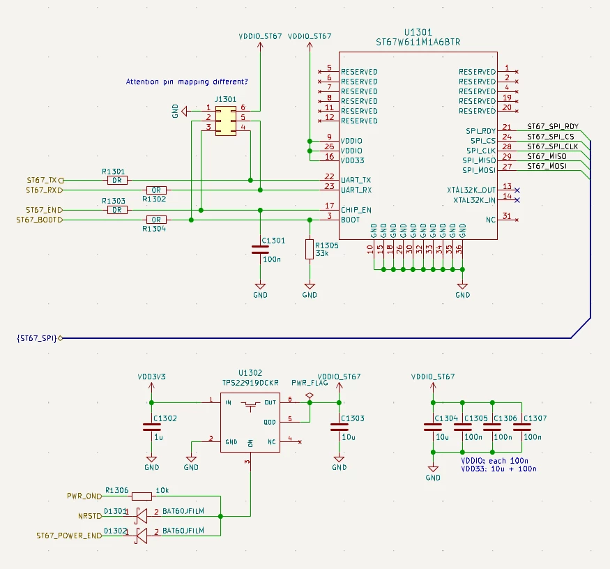

Based on the discovery board and the ST67 nucleo, I have designed my own PCB. I have three times the exact same board. 001, 002 and 003.

For flashing the firmware, I have used the N6-Nucleo connected to a header on my custom PCB.

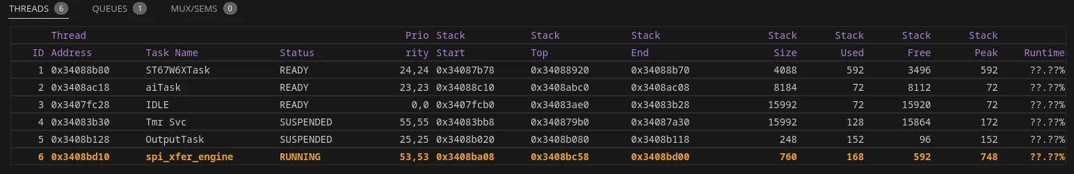

Board002 and 003 end in a UsageFault when running the exact same firmware as on board001. If i remove MX_ST67W6X_Init();, the rest of my firmware runs fine. Here are some debug prints from my fault handler:

This looks like a stack overflow, but stack of XYXY task seems reasonable:

The hardware itself looks okay. I have already resoldered one of the ST67 modules, but nothing changed. My schematic is very basic. VDDIO_ST67 is correct on all boards.
I do not understand, how one out of three boards does not end in a UsageFault with the exact same firmware (eval boards work as well). Does someone have any more suggestions for debugging? I do not know how to continue. Any help is appreciated!
