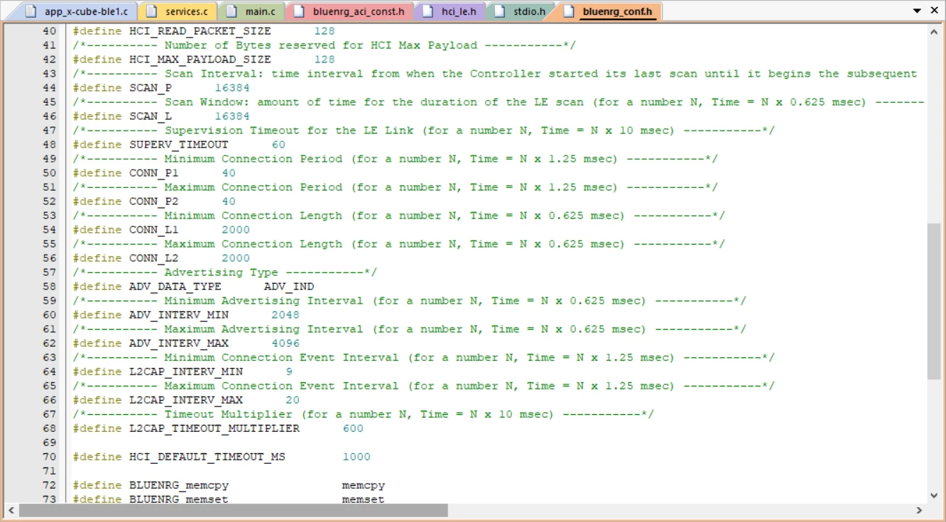

    0693W000006GuEAQA0.pngHello Winfred,
    Thanks for the answer, for observation 2 it's the same device but would finally upload a project I would try before, must be some kind of delay or something a lot of these projects have the same address so maybe that's the reason why.
    I'm going to try what you mentioned in observation 1, I found the intervals in the bluenrg_conf.h as shown above and will make adjustments to them. Do you have any practical book to recommend for dealing directly with the bluenrg code for ST? I anticipate I will run into more troubleshooting

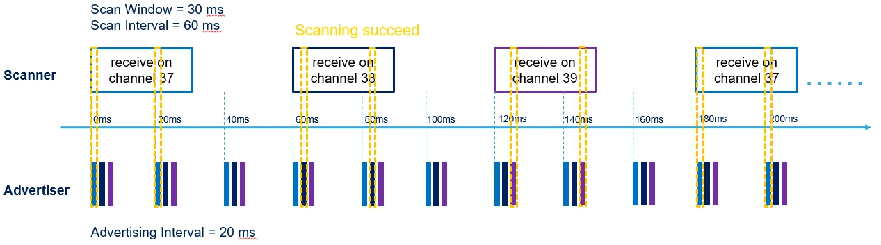

    In brief, configure a shorter advertising interval and longer scan window to have better successful rate of scanning.
    Refer to the following diagram explaining the relationship between the advertiser (advertising interval) and the scanner (scan window, scan interval).
