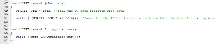

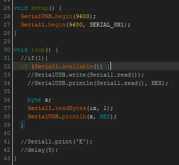

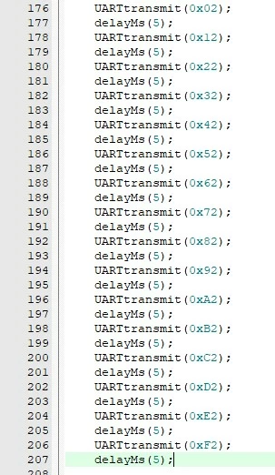

    I have wrote it myself. here is the arduino and the TX code.0693W00000DqLOPQA3.jpg0693W00000DqLOKQA3.jpg0693W00000DqLNlQAN.jpg

    whats wrong with USART_SendData()?
    also the while(!USART.... (active wait ) should be checked before the transmission attempt not after.

    I am trying to not use the HAL lib. But I should try same thing with the HAL​ to see if it's hardware and also check the tx register empty bit before transmit

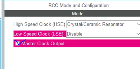

    Problem solved. After a couple of days I have decided to check the uart with lower main clock frq and apparently it works under 86mhz

    Maybe your XTAL pcb traces have huge capacitance or you placed the sligtly bigger than needed capacitors?(or youre using one of those RC resonators instead of a xtal)
    You can figure out the real clock your chip is using by probing with an oscilloscope very fast PWMs or outputing master clock directly to a pin.
