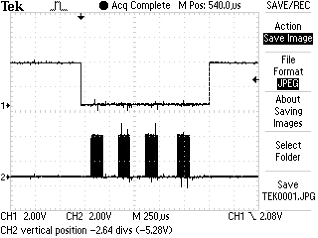

Dear everyone,
I'm trying to use a SX1280 for RF connectivity.
My dev board is the official... the SEMTECH "SX1280ED1ZHP", it's included a nucleo + daughter board with SX1280.

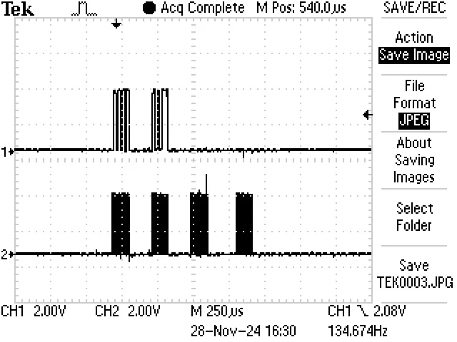

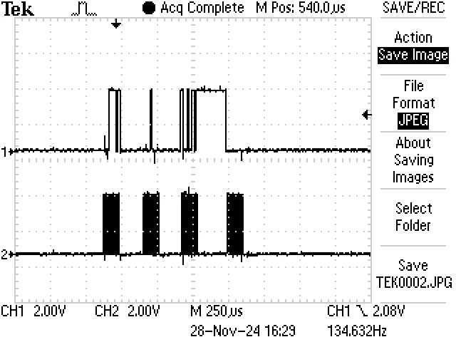

My diffculty is that a not able to read correctly a register with a know value after reset.
Second thing, a see Something wrong at scope.
So i'm here because a would like help.
#IOC Spi configuration
#Define
#define SX1280_SPI &hspi1
#define SX1280_NSS_PIN GPIO_PIN_8 // Replace with your NSS pin
#define SX1280_NSS_PORT GPIOA // Replace with your NSS GPIO port
#define MANUAL_GAIN_REGISTER 0x0895
 #Read Function
 	 uint8_t SX1280_ReadRegister(uint16_t regAddr) {
 uint8_t command = 0x03; // Read register command
 uint8_t addrHigh = (regAddr >> 8) & 0xFF; // High byte of the register address
 uint8_t addrLow = regAddr & 0xFF; // Low byte of the register address
 uint8_t dummy = 0x00; // Dummy byte for clocking out the data
 uint8_t regValue = 0x00; // Variable to store the register value
 HAL_GPIO_WritePin(SX1280_NSS_PORT, SX1280_NSS_PIN, GPIO_PIN_RESET);
 	 HAL_SPI_Transmit(SX1280_SPI, &command, 1, HAL_MAX_DELAY);
 	 HAL_SPI_Transmit(SX1280_SPI, &addrHigh, 1, HAL_MAX_DELAY);
 HAL_SPI_Transmit(SX1280_SPI, &addrLow, 1, HAL_MAX_DELAY);
 	 HAL_SPI_TransmitReceive(SX1280_SPI, &dummy, &regValue, 1, HAL_MAX_DELAY);
 HAL_GPIO_WritePin(SX1280_NSS_PORT, SX1280_NSS_PIN, GPIO_PIN_SET);
 return regValue;
#Function Call
uint8_t manualGainValue = SX1280_ReadRegister(MANUAL_GAIN_REGISTER);
 My aim is to read the MANUAL_GAIN_REGISTER, at addr = 0x0895.
From the datasheet, the reset value must be 0x01.
The value received is 0x00.
Channel 1 : CS / Channel 2 : SCK
Channel 1 : MOSI / Channel 2 : SCK
Channel 1 : MISO / Channel 2 : SCK
if someone have an idea... thanks !
