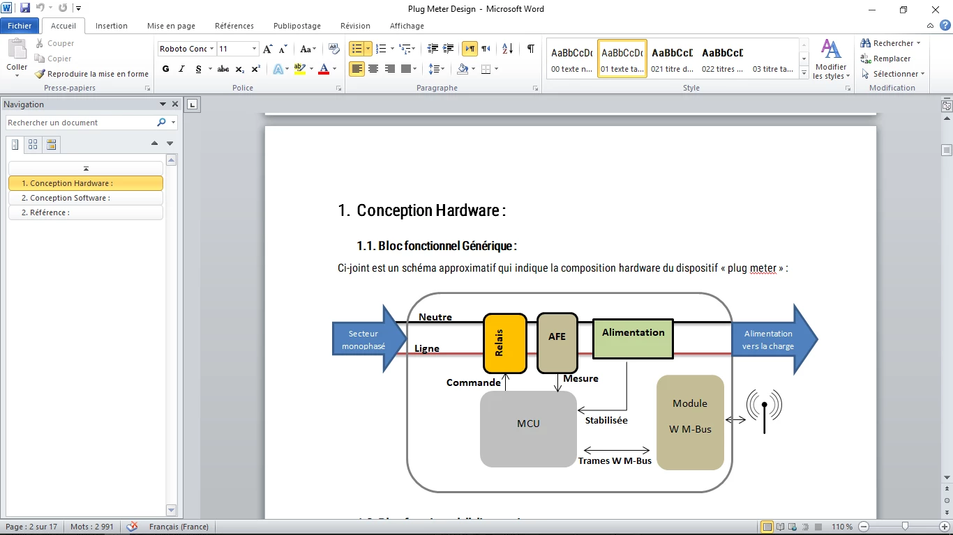

    No, in fact i am willing to design my own board, using a MCU from ST (STM32f030K6T) and an AFE module (STPM...).
    I imagined this design:

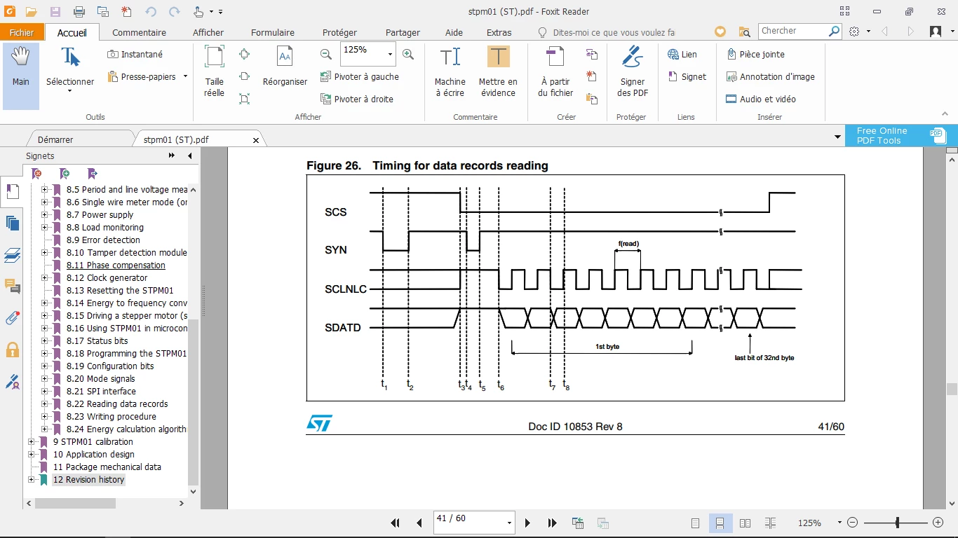

    There for, i need to establish the low level communication layer between MCU and AFE, but i couldn't find in your datasheet, some software libraries to facilitate the communication; (only hardware description of SPI :
    Am i forced to create my own Hardware Abstraction Layer (HAL) for the AFE ??

    You design is something like this... ?
    http://www.st.com/en/evaluation-tools/steval-rfplug01.html
    I suggest to use STPM32/ STPM33 / STPM34
    Look for Evaluation Tool Software at
    http://www.st.com/en/data-converters/stpm33.html
