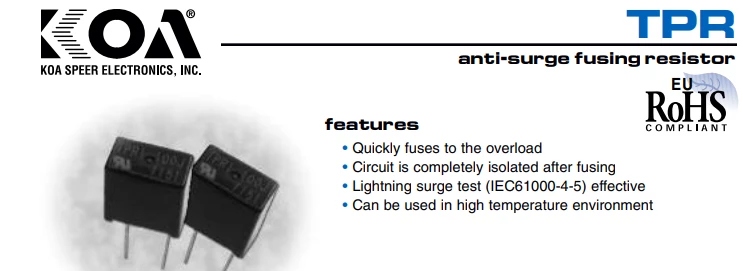

AScha.3
Jul 8, 2024 2:08 PM UTC
>2> I don't know the max tolerated deviation of the RTX for proper functionality.
Me too. :)   So we cannot design a proper replacement for RTX . It is 68 r.
Maybe you could use a "fuse" resistor...(i dont know, whether you want+ can get this kind of resistor.)
660-TPR1CTA680J (mouser)  1 W type :
