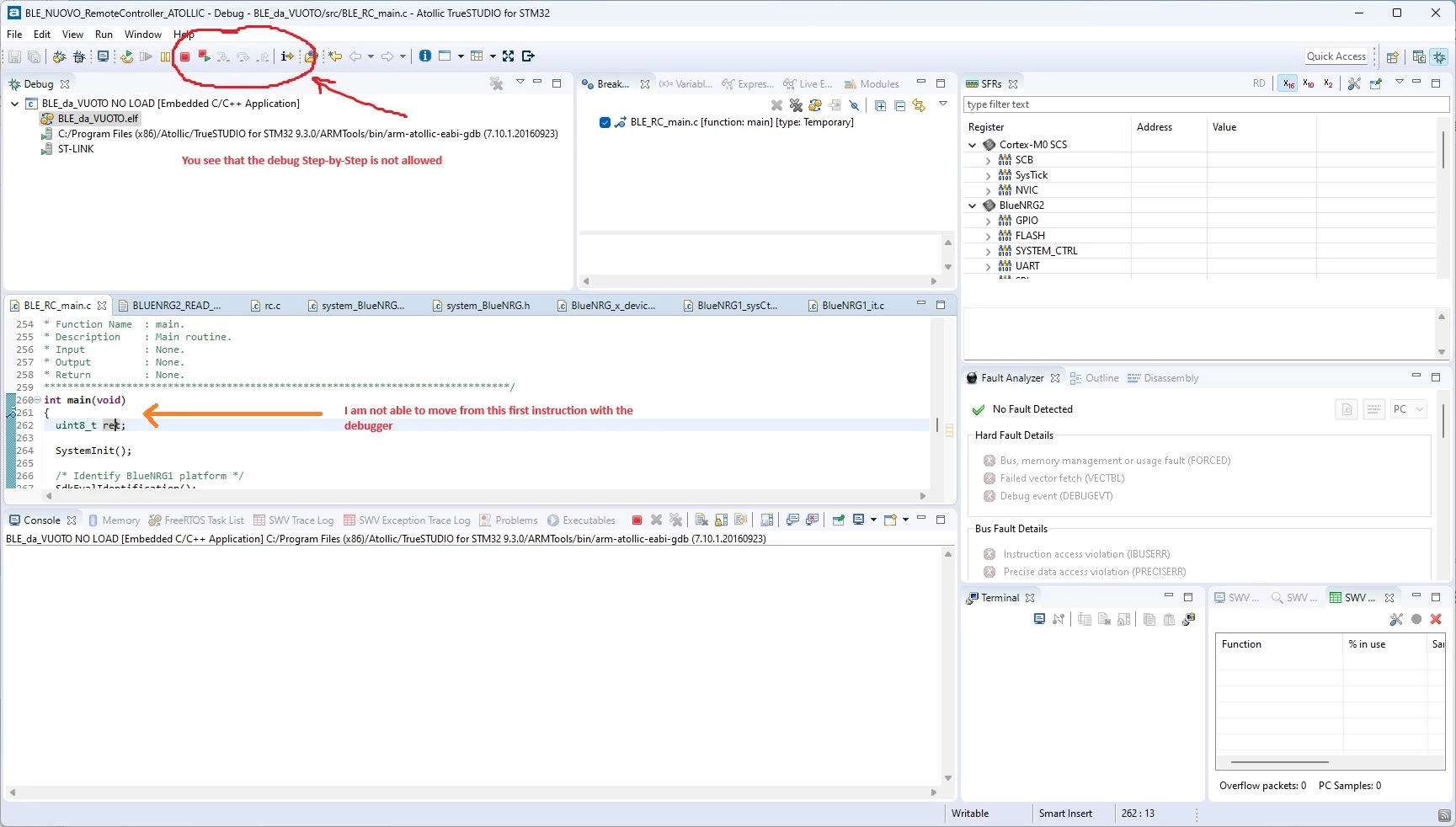

STEVAL-IDB008V1M - ST-Link-V2 debug with Atollic True Studio
my name is Mario and i have some troubles while debugging a program for the STEVAL-IDB008V1M eval board.
Configuration
STEVAL-IDB008V1M evaluation board
Atollic TrueSTUDIO Version: 9.3.0
In the Atollic IDE, I installed the ST-Link Utility.
I compiled the original example "BLE Remote Control" (provided with STEVAL-IDB008V1M board) by means of  Atollic.
I found on the net the followinf piece of advice:
It will force BlueNRG-2 DIO7 to "1" before doing a reset so that BlueNRG-2 will remain in bootloader.
When trying to flash from any IDEs, you must force DIO7 to "1" before doing a HW reset or a power on / power off.
and I applied it.
RESULTS
In the above conditions, the debug results are null and disappointing:
for few seconds the connection with debugger seems working but it diseppears quickly: the debug process is not able to start.
This is the message I got on the console
STMicroelectronics ST-LINK GDB server. Version 5.1.0
Copyright (c) 2018, STMicroelectronics. All rights reserved.
Starting server with the following options:
Persistent Mode : Disabled
Logging Level : 1
Listen Port Number : 61234
Status Refresh Delay : 15s
Verbose Mode : Disabled
SWD Debug : Enabled
Waiting for debugger connection...
Debugger connected
Target is not responding, retrying...
Error! Failed to read target status
Debugger connection lost.
Shutting down...
You see below a picture of the debug window: the standard step by step debug is not allowed.
I kindly ask for your help.
Best Regards,

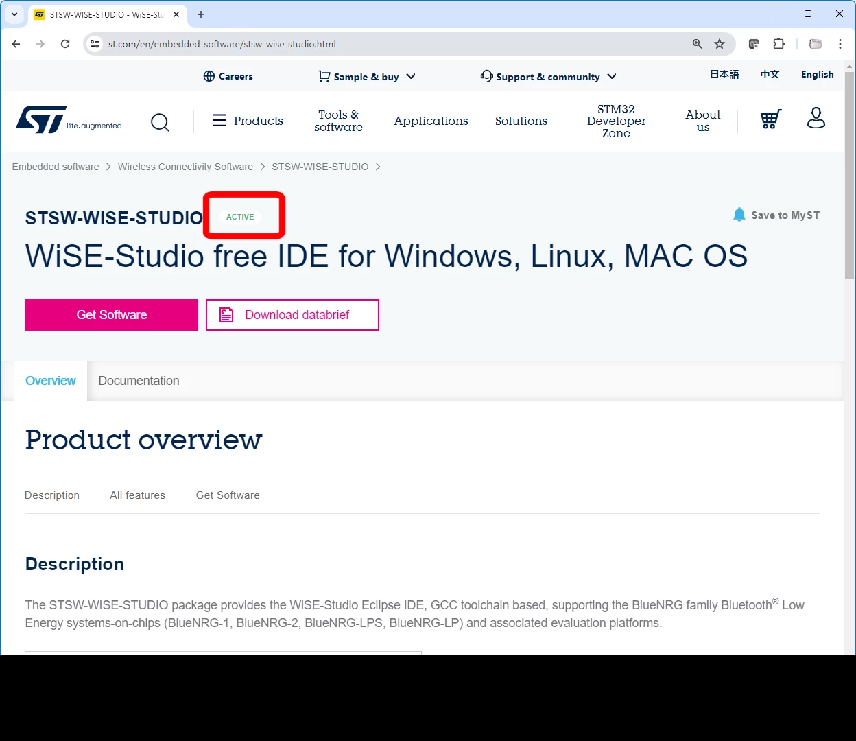

@MSand.1 wrote:
I was told that Wise Studio is also an old IDE.
ST say it's 'ACTIVE':
https://www.st.com/en/embedded-software/stsw-wise-studio.html
