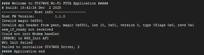

Dec 4, 2025 7:58 AM UTC
A reason for this is probably that the binary on the NCP is not updated to the same version as the host FW. The 0x5501 value was used in the initial SW in modules shipped after the release.
I'd suggest updating the binary, using to the attached scripts in \Projects\ST67W6X_Scripts\Binaries - described in https://wiki.st.com/stm32mcu/wiki/Connectivity:Wi-Fi_MCU_Hardware_Setup#Flashing_the_ST67W611M1_using_QConn_Flash_with_an_STM32_host.

Hi @TarikAb ,
I'm giving it a try right now using a STM32H573I-DK and the X-NUCELO-67W61M1.
I cannot get the H573 to send data over the SPI port.
This is causing a failure for the start of the FOTA app.
I'm trying currently in station mode, before trying to switch to AP mode.
I did rework the ST67W board to use the on-board 32.768khz crystal which fixed one of the issues that was seen on the ST67W's UART interface.
The pins are matching for SPI using the Arduino header. I am using software pins for RDY and for NSS.
From my reading of the generated code, the SPI2 didn't seem to get initialized.
I did try initalizing it before the MX_ST67W6X_Init by using MX_SPI2_Init without success.
Any pointers to a solution?

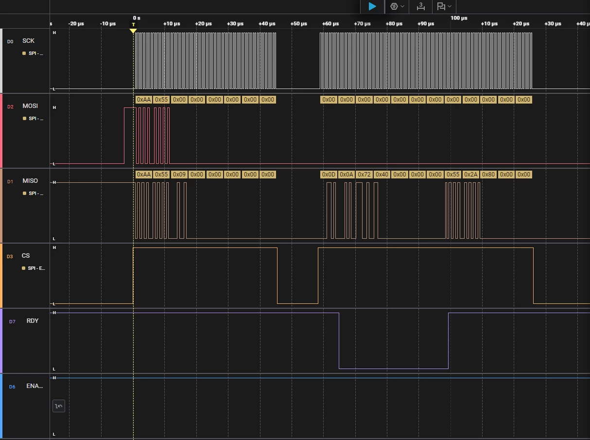

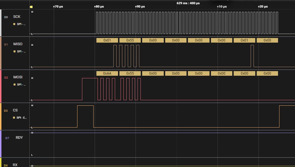

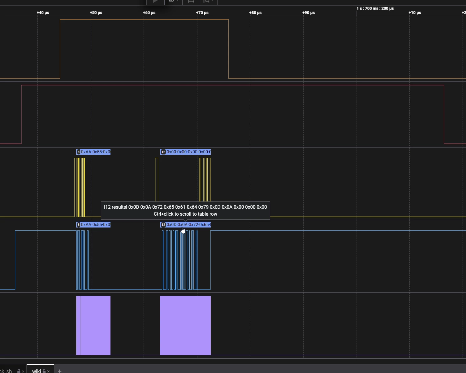

Dec 2, 2025 8:12 PM UTC
Got some progress,
I fixed the interrupts and intialization for SPI2. Now I get the module to communicate but the driver expects 0x55AA as the first magic code for the header, and I receive 0x5501 instead.
I did clock the SPI clock to 1.43 MHz due to instability at a higher clock.
The datasheet dosen't mention this magic constant, nor 0x55AA seems to be a "word" in the AT protocol.
Here is a logic analyzer capture of the data exchanged between the 2:

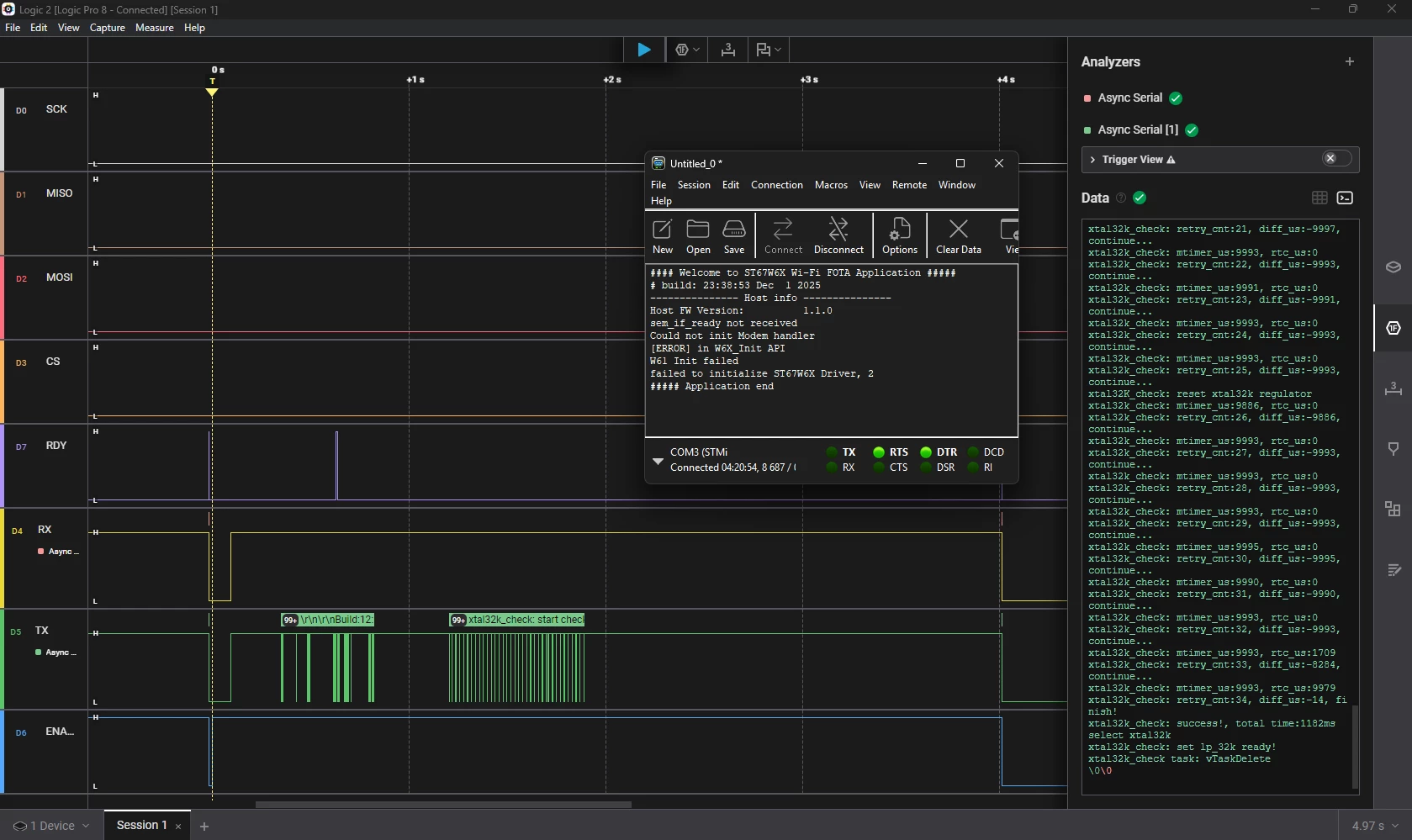

I also captured the UART traffic between the ST67W and the STM32H573.

xtal32k_check_entry task enable, freq_mtimer must be 1MHz!
--------------------------- use passive crystal.
xtal32k_check: delay 100 ms

\x1B[0m[I][MAIN] [APP] [EVT] wifi_event_handler, CODE_WIFI_ON_INIT_DONE
wifi_mgmr_set_country_code:code = Wd
\x1B[0m[I][MAIN] [APP] [EVT] wifi_event_handler, CODE_WIFI_ON_MGMR_DONE
xtal32k_check: start check
xtal32k_check: mtimer_us:9987, rtc_us:0
xtal32k_check: retry_cnt:1, diff_us:-9987, continue...
xtal32k_check: mtimer_us:9991, rtc_us:0
xtal32k_check: retry_cnt:2, diff_us:-9991, continue...

@TarikAb is there additional documentation about the 0x55AA and the specific things outside of the AT protocol for the ST67W?
EPASZ.1
EPASZ.1Best answer
Dec 4, 2025 1:41 PM UTC
Hi @EPASZ.1 ,
thanks for the tip about the firmware.
I did manage to update it without a Nucleo U575 host! I went with the T2 mission firmware. Is it the correct one?
QConn_Flash\QConn_Flash_Cmd.exe --port COM8 --config NCP_Binaries\mission_t02_flash_prog_cfg.ini --efuse=NCP_Binaries\efusedata.bin
We got progress:
#### Welcome to ST67W6X Wi-Fi FOTA Application #####
# build: 20:32:07 Dec 2 2025
--------------- Host info ---------------
Host FW Version: 1.1.0
spi rx transaction timeouted
Failed to receive the remaining bytes
spi txrx failed, -1
Failed to do the first transaction
waiting for spi txn ready timeouted
sem_if_ready not received
Could not init Modem handler
[ERROR] in W6X_Init API
W61 Init failed
failed to initialize ST67W6X Driver, 2
##### Application end
I'll keep digging into the code to see if I missed something again.
Thanks,
EPASZ.1
