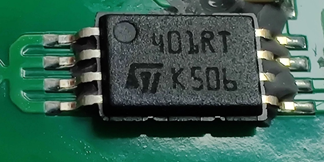

ST part from marking code I am trying to find ST micro part from marking code given on it. It is 8 pin IC. Code is as below - First line: 401RT Second line: K50b

    The second line is K506.

    okay then what is this IC??

    ​Hello,
    This is a 1Kbit EEPROM memory. Range 6 in TSSOP8 package.
    M24C01-RDW6
    https://www.st.com/content/st_com/en/products/memories/serial-eeprom/standard-serial-eeprom/standard-i2c-eeprom/m24c01-r.html

    I also have a similar TSSOP8 IC made by ST.
    In the first line is written : 504RQ
    and in the second line : K750
    I appreciate if someone could help me what is this IC.

    Probably 25C04
    2.5V to 5.5V for ST25x04 version
    https://pdf1.alldatasheet.com/datasheet-pdf/view/23688/STMICROELECTRONICS/ST25C04.html
    Second line is production location/data code
