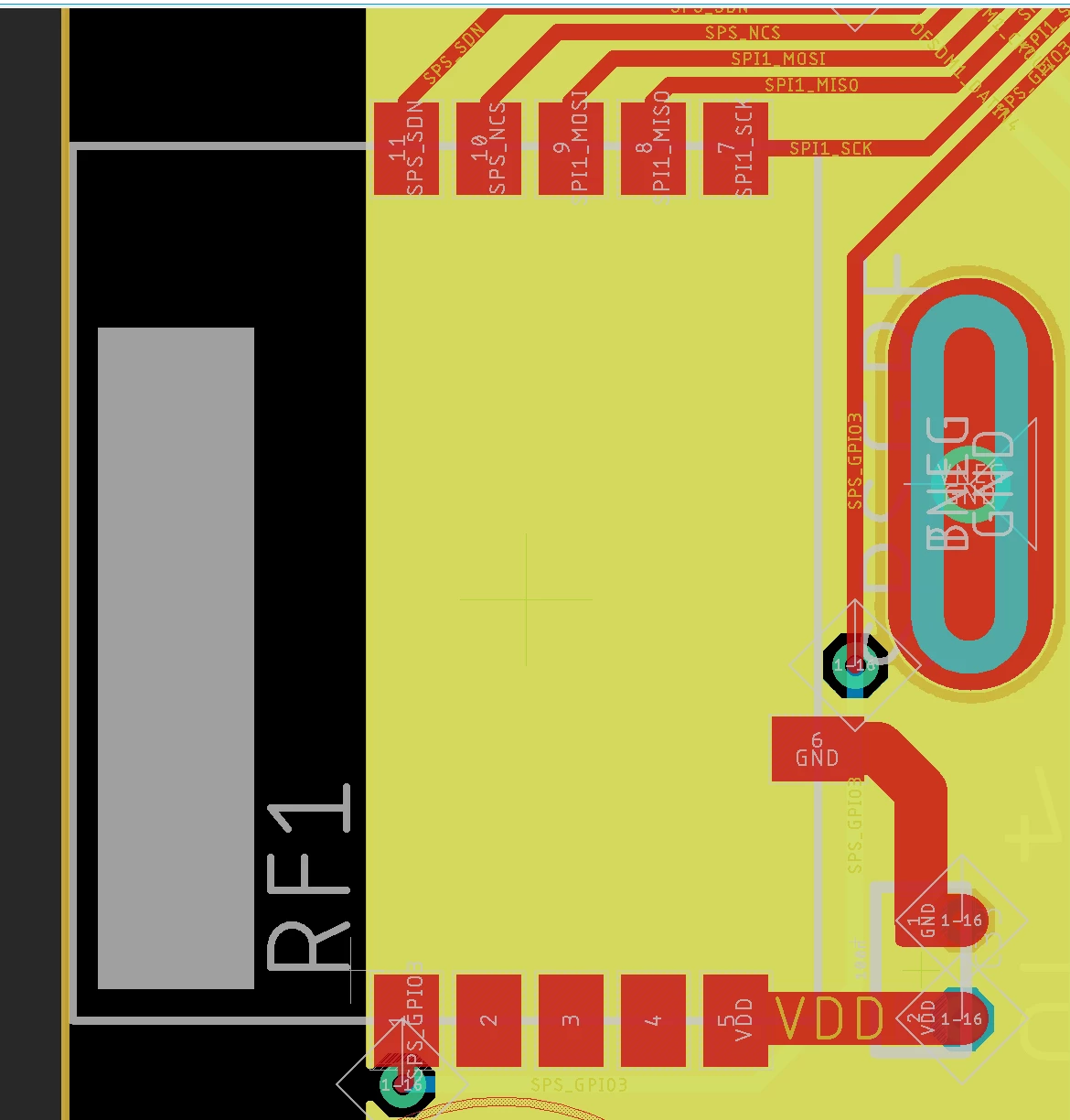

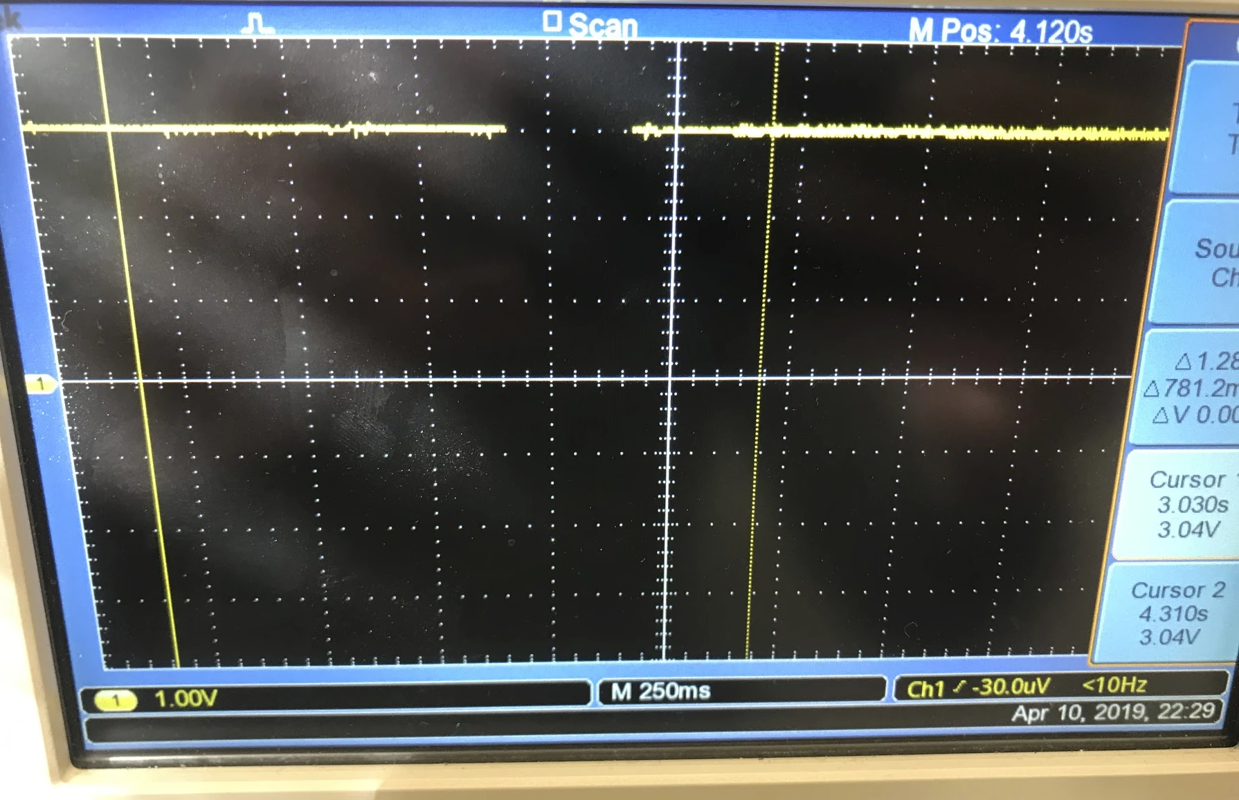

Here I attached the measurement on the power supply pin wrt ground and also I attach the part of the PCB. The yellow one is ground, similar to other boards that use SPSGRF0690X000008AGyRQAW.png0690X000008AGyMQAW.png
Do you think that the problem could be the ground plane?
enrico239955
Apr 10, 2019 8:10 PM UTC
I assume here that you measured the 3 V power supply voltage during RF transmissions.
That being said, the 3 V power supply signal seems stable during the RF bursts. Therefore the problem is not the power supply.
I took a look at the second picture you published. It seems that below the antenna there's no ground plane. If that is the case the problem is not the ground plane.

Ground planes below antennas are bad. They modify the parameters of the matching netowrk that was carefully designed and tested by ST.
ST designed the matching network in order transform the impedance of the antenna to the complex conjugate of the output impedance of the power amplifier. That means that the imaginary part of the impedance seen by the power amplifier is zero and half of the power is delivered to the antenna.
The other half of the power becomes heat.

Anyway the measurements on the oscilloscope were made during both rx, sleep and tx state, the radio stack handles them.
