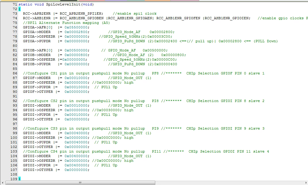

am using 4 chip select lines for 4 salves
*** when i test with 3 slaves it work perfect ***
after adding 4 th slave this problem starts

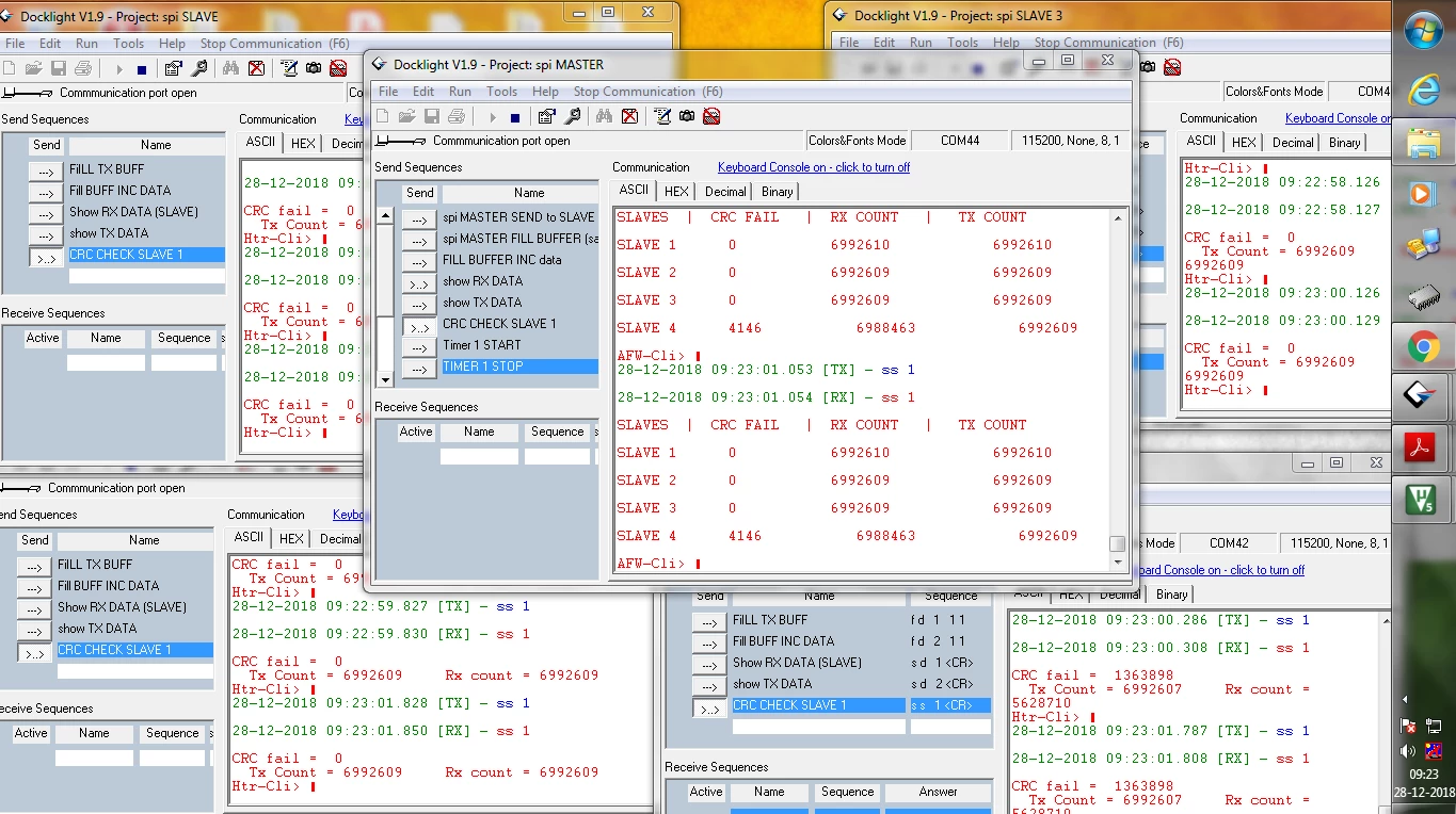

Initially all slaves work correctly bt after some lakhs of tx and rx it SLAVE 4th get errors
so how to correct it.

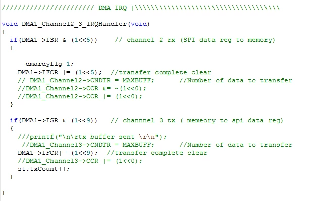

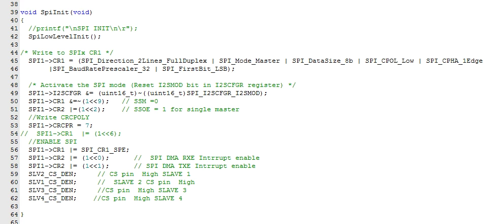

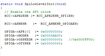

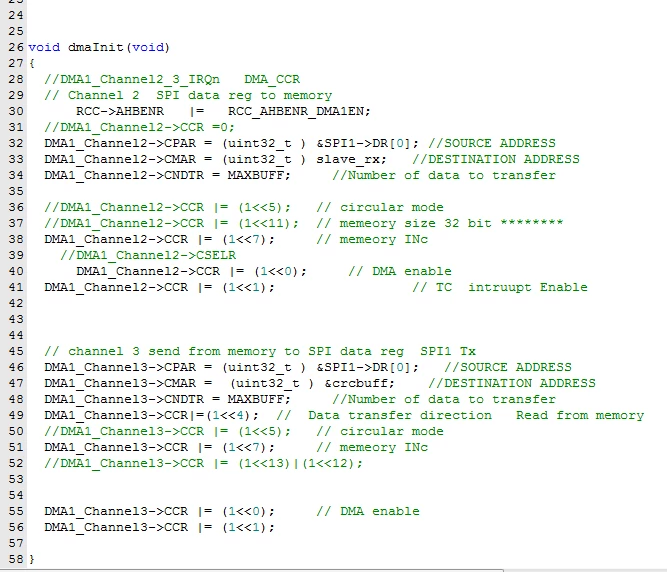

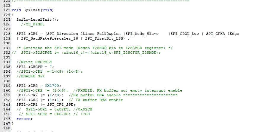

M0 SLAVE SPI AND DMA CONFIG

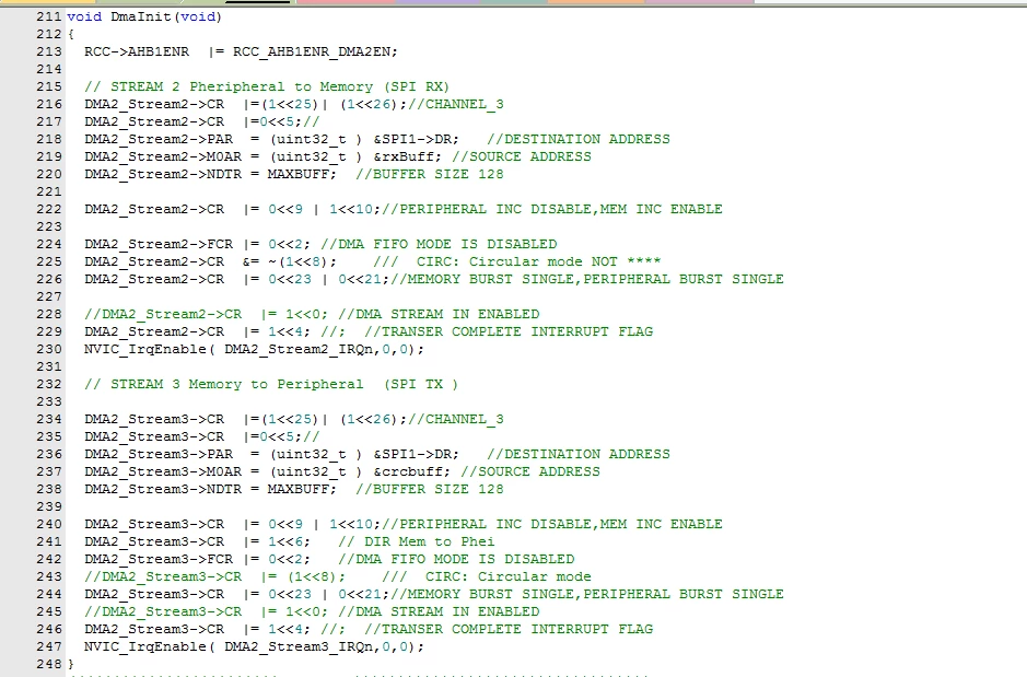

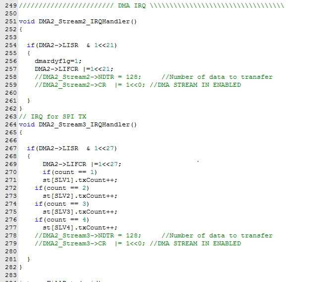

**** MASTER SIDE SPI AND DMA CONFIG ****
below:
(Cortex M3) MASTER stm32F20x
Thanks in advance.

An SPI transaction is complete once its RXNE flag is set. (not TXE).
Use NSS rise/fall edge to reset/reconfigure the SPI for the next transfer.
Add some slight delay on master side between NSS toggle and SCK data activitiy start.

The most important to remember in SPI mode is that the TXE will occur just when you write the data register, while the RXNE will occur once all the clock bits have been actually been transiting on the SPI bus. Going higher level, the DMA RX usually is used as possible interrupt source, never the DMA TX which is only used in master mode to generate the required number of clock pulses. (in 4 wire mode which is the default reference for me).

bt still i want to know why it works perfectly with 2 or 3 or 5 slaves
not with 4 slaves.
S.Ma
Principal
Jan 5, 2019 7:16 AM UTC
This would be debugging, I've got 1 master with 12 slaves MCU running on 12MHz SPI with 2048 bytes packet every 3 msec with no errors over hours in one of my hobby project.
First, have you checked it's not a timing issue?
For example, sequence swap 4 and 2 and observe where the bug shows up.
If there are other possible interrupts that could happen in master or some slaves generates this side effect.
Second, check if the memory addressed by the DMA contains the right range and data, When there is wrong memory location, you may generate wrong data fillup and old one remains.
By not using NSS to synchronise the slaves to the master is like implementing an I2C bus without the START/STOP bits.
Debugging master - slave SPI is a bit more tricky as you have to debug on both sides. Also check if the first, second talk between master ans slave starts right or wrong.
A good way to debug is to put a transaction counter in the message you are sending.
Ideally, also put the intended slave target number, this way, you can breakpoint conditionality and get some clues for debugging.
Good luck!
