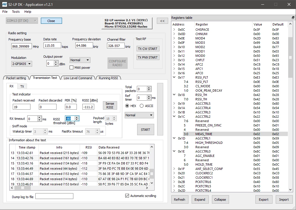

The RSSI Threshold setting doesn't seem to lower the sensitivity of the receiver.
I set the Threshold to -80dBm but the receiver still tries to receive random data out of noise with RSSIs around -110 with PQI&SQI above threshold.
The rx communcation is more sensitive to errors than similar tranceivers i used in the past. Maybe someone can help me with this issue.
(Same behavoir on the Demo Board and my Prototype)
Screenshot of the S2-LP DK application.
