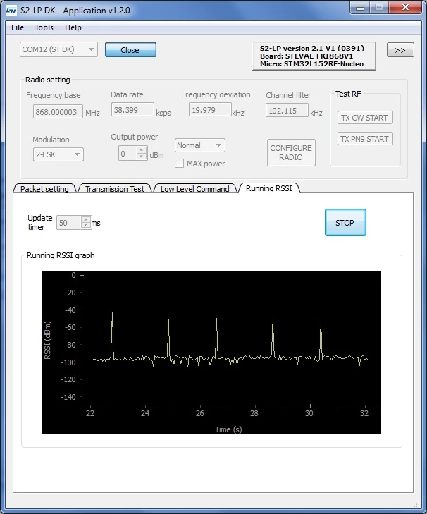

Now I have a different issue. With my custom microcontroller board, when I connect the
STEVAL-FKI868V1 board using SCL, SDI, SDO, SDN, CS and GPIO3, the board transmitts fine (I am using Basic_Generic_A TX code) and on my other STEVAL-FKI868V1 kit (with nucleo) it receives fine and decodes the payload perfectly. But when I just replace STEVAL-FKI868V1 board with my custom RF board with my microcontroller board, I see that it transmits the signal but on the receiver STEVAL-FKI868V1 kit, it does not decode. I have attached the pic of RSSI with this. All other conditions remain the same (same modulation, data rate, bandwidth etc).
Where should I look? The balun could be the reason? Seems all the components are soldered as expected. Any help or suggestion?
Thanks
Silas

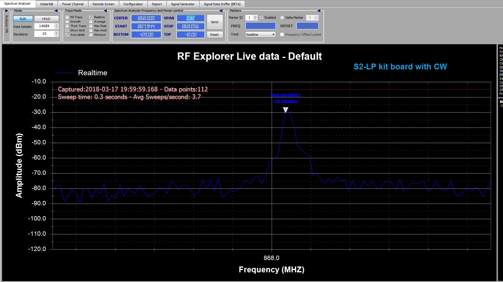

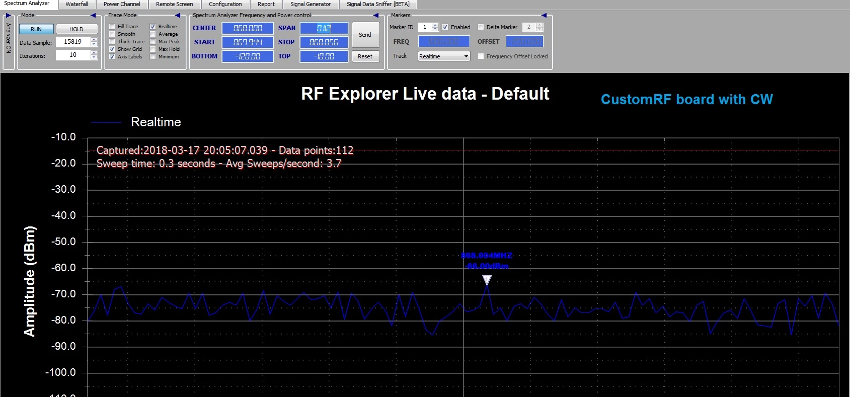

Here is some more findings after I did some more test using CW mode
Coded for CW mode (no modulation) : Running the code for CW with S2-LP kit board with my controller board - and looking at the spectrum analyzer - it shows nice peak of -30dBm at 868Mhz, I have included the pic below. And then replacing the kit board with my custom RF board, I see no such peak for 868Mhz, but kind of spread, seems lot of harmonics, also included the pic below
Can this behavior be because of the balun
BALF-SPI2-01D3 mismatch? Seems like there is no selectivity for the 868Mhz.  Can anyone help on this please?  Should I update my design to use the discrete components instead of the balun? The only benefit of using the balun is reduced component count and smaller PCB. I would really appreciate any of your feedback..
