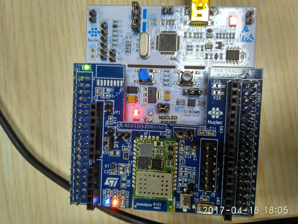

Hardware
:NUCLEO-F401RE,X-NUCLEO-IDW01M1
Software
:STM32CubeExpansion_WIFI1_V3.0.1
IDE
: iar arm 7.1

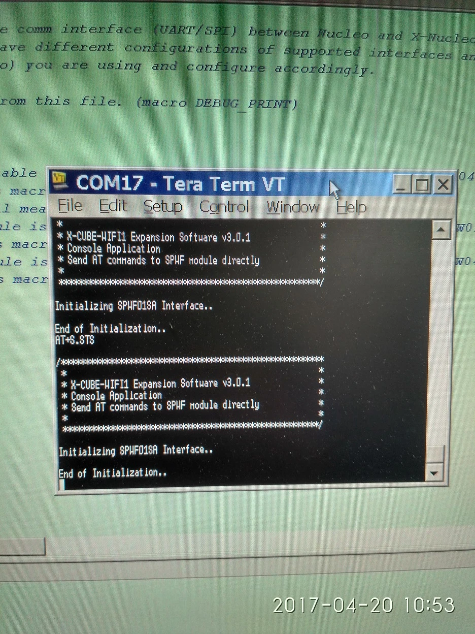

From the example project I found two types one is SPWF01 another is SPWF04, I found the exampleBinary is the SPW
I change the config to SPWF01,but it still not work.
1)en.x-cube-wifi1_firmware (1)\STM32CubeExpansion_WIFI1_V3.0.1\Projects\Multi\Applications\
WiFi_VCOM
From the Tera term I found the print message,but when I input 'AT+S.STS',nothing output.

I feel so sadly,
I try to update the firmware of the SPWF01S, but the Flash loader demostrator : FAIL:unable to erase flash.
Now I am waiting for the FAE of ST come to solve my problem.
The demo project is for SPWF04 and I do not know where is the problem hardware or software.
The best way is using the default hardware for the demo.
If we can not run the demo, update the WIFI module is more difficult.

Thanks a lot for your suggestion,I try the mbed example but still not work,I use the
oscilloscope to monitor the RX and TX lines and find nothing receive from the RX line.Maybe the WIFI module is broken.
Gerardo GALLUCCI
Apr 29, 2017 3:10 PM UTC
Posted on April 29, 2017 at 15:10
Hi Kerry,
about the module, it should give something on its TX line after reset or poweron (WIND:1, typically). Moreover, you can monitor GPIOs 10 or 13 or 14 (they should go high, or blinking). If none of two options are in place:
- module is broken -> I don't think is broken, since you get '
', that is after initial Flasher handshake
- module was erased (fully, or initial page containing bootloader) -> do not never erase addresses before 0x08002800
- module is in boot mode (boot pin is high)
Can you check internal flash by 'Flash loader demonstrator' tool using a UART2USB device connected to TX and RX module's lines?
http://www.st.com/content/st_com/en/products/evaluation-tools/solution-evaluation-tools/communication-and-connectivity-solution-eval-boards/steval-pcc018v1.html
 is the one I use.
kerry liu
kerry liuAuthorBest answer
Jun 6, 2017 12:51 PM UTC
Posted on June 06, 2017 at 14:51
Gallucci.Gerardo
Das.Mridupawan
Thanks a lot for your help.
The board is OK now, the FAE help me update the firmware of the WIFI module.
It work fine now,
