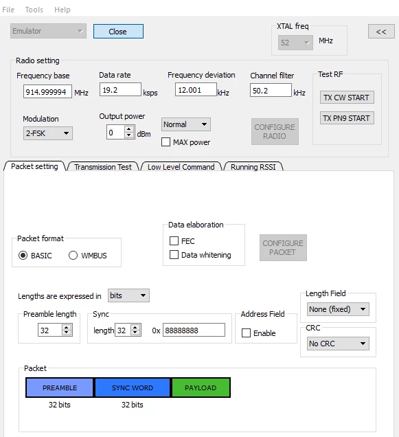

I have been attempting to use Silicon Labs Si443x/RFM22 ISM radio IC for over a week now with no success. My overall impression of this radio IC is poor. Lots of issues, erratas, and twitchy-spazz operation even under ideal conditions. So naturally I am looking for another line.
What about SPIRIT1 ISM radios ? What is your experience ?
Looking for 915MHZ, FSK/2-FSK modulation, 19.2KBPS, simple packet handling with preamble - sync - 5 byte fixed packet length - no crc. And most of all, few hassles, no twitchy spazz operation, no complex software/hardware work-arounds for a poorly designed IC, no wondering WTF, why did it do that ?, that's not in the datasheet.
If you can't get this working in a simple one transmitter, one receiver setup located in Faraday Cage in a couple of hours (tops), then I will keep looking.
Looking forward to your responses.

    Hi gahelton,
    Both SPIRIT1 and S2-LP can be suitable for the task.
    It can be simply configured through SPIRIT1 / S2-LP DK GUI, on top of a STM32 Nucleo board + SPIRIT1 / S2-LP expansion board, like:
    I'm sure it will take less than 1 hour to setup the boards to test.
    Thank you.
