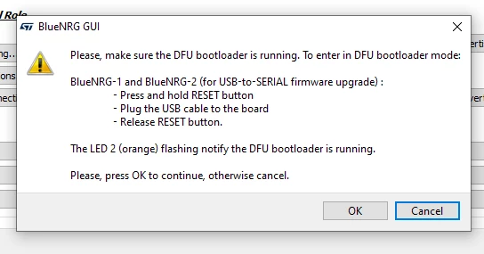

When I update the motherboard under tools menu this message is displayed (on the picture)
I try but the LED does nothing.
Then I choose the file USB_to_SERIAL.hex, but it displays "No DFU board found".

Actually I'm having this issue with the STEVAL-IDB008V2 not the X-NUCLEO. I can upload the DTM_UART.hex as described in the documentation but the GUI software is then unable to connect to the device in DFU mode after displaying the popup shown above (the LED is flashing). I tried installing the driver with C:\Program Files (x86)\STMicroelectronics\BlueNRG-1_2 DK 3.2.1\PCDriver\DFU\dpinst_amd64.exe but it doesn't appear to install, maybe that is the issue. I'll try with ST-Link.
Thanks
Winfred LU
Aug 31, 2021 1:34 AM UTC
Do you mean DL2 is flashing? If so, the onboard STM32 has been in DFU mode already. This can be doubly checked in Device Manager, under Universal Serial Bus controllers there would be a STM Device in DFU Mode.
Please just flash the MCU with USB_to_SERIAL.hex

0693W00000DlftmQAB.png0693W00000DlftwQAB.pngYes, it is in DFU mode and showing in device manager but the software can't find it.

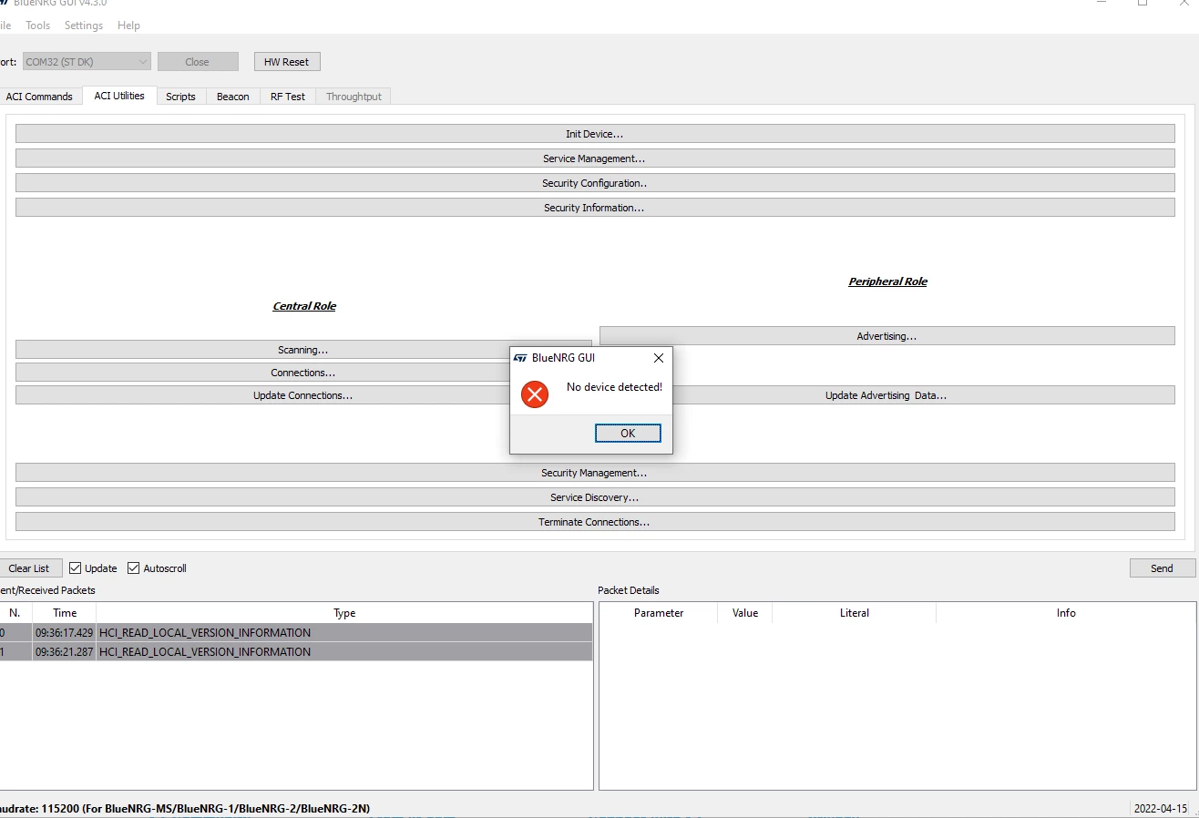

I have a similar issue using the board STEVAL-IDB009V1, when I try to open it on BlueNRG gui, I get an error message "No device detected". I can program it with BlueNRG-2 Navigator so I don't really know where is the problem.
