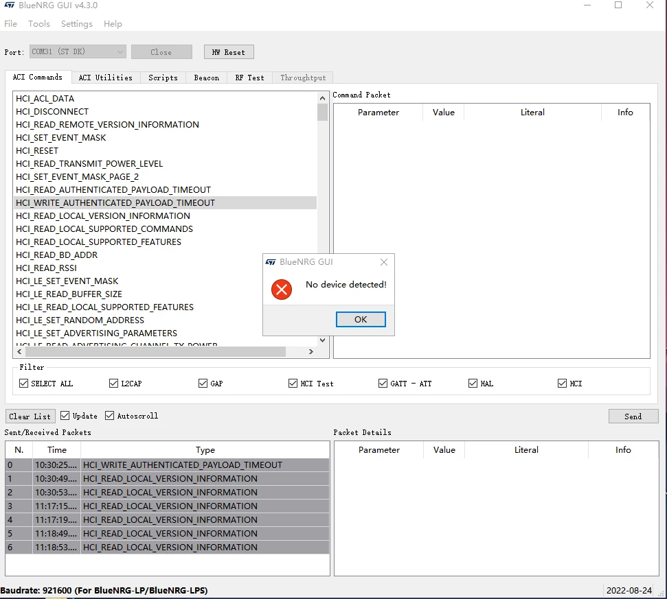

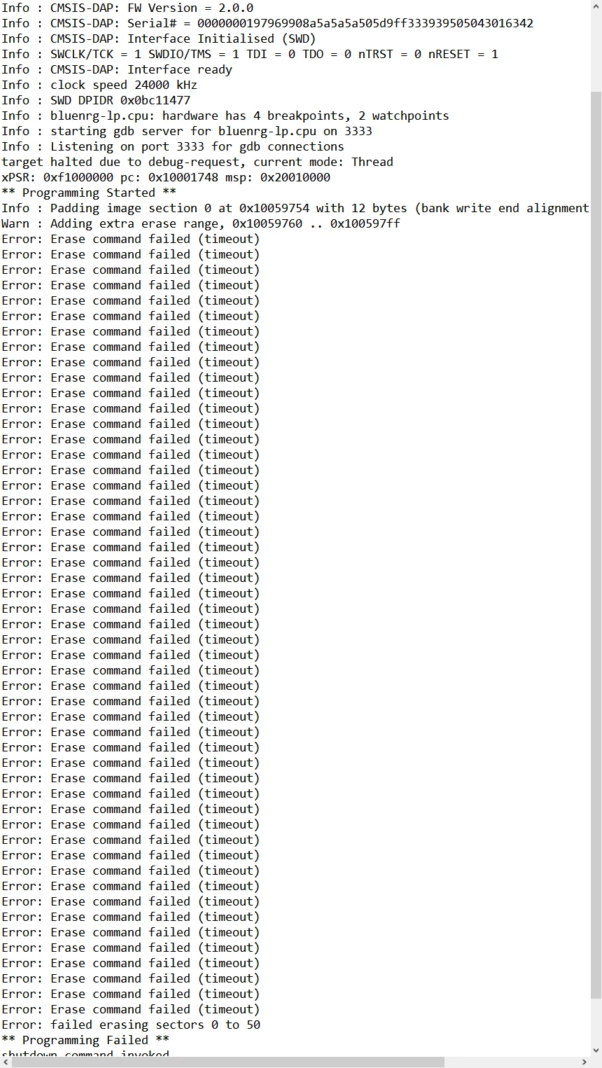

My STEVAL-IDB011V1 board Unable to download firmware
  • August 24, 2022
  • 1606 views
When i use WISE Studio Build the demo project, Then Run;There comes the problem.0693W00000QOMYMQA5.pngMy computer can recognize the board.
0693W00000QOMZ0QAP.pngAlso The BlueNRG GUI Tools can read DK Serial port .But can not Successfully connected.

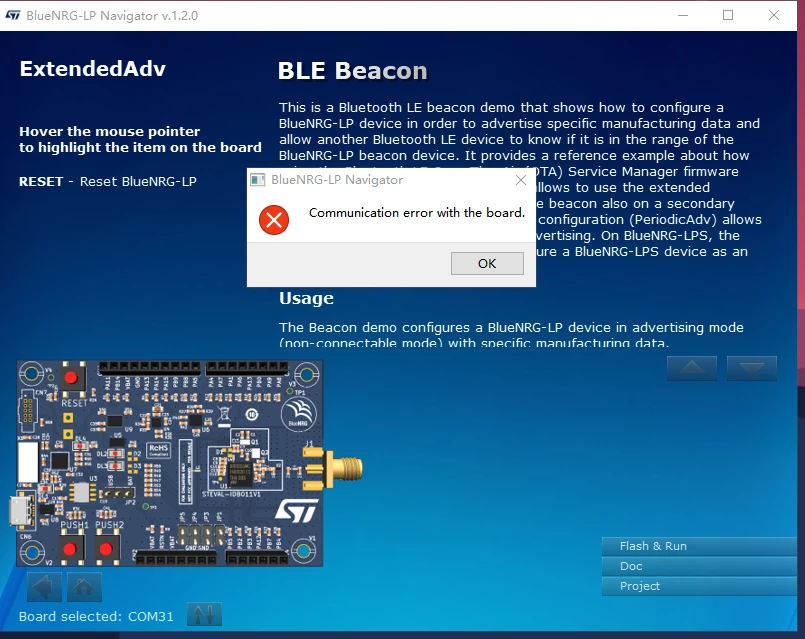

​There also the BlueNRG-LP Navigator tools.0693W00000QOMarQAH.pngI don't know why this problem occurs.anybody have any idea?

    May I suggest to check if CMSIS DAP is properly installed
    Can you try below steps?
    • Reflash USB_CMSISDAP_LPS.hex
      • Remove USB cable
      • Press and keep pressed reset button while you plug USB cable
      • Board will appear as "Maintenance" in your Windows folder
      • Drag and drop USB_CMSISDAP_LPS.hex present in SDK (ST\BlueNRG-LP_LPS DK 1.2.0\Firmware\USB-CMSISDAP)
    Then you should be able to use
    • The Navigator tool to flash the DTM UART binary that will allow to use the GUI
    • RF flasher or your IDE to flash tour own binary.
    Regards
    Laurent
    elv.1
    elv.1Author
    August 30, 2022
    thanks for your suggestion. i have tried Reflash USB_CMSISDAP_LPS.hex, it's ok. Then, when i flash the binary. there also something wrong as  I described before. Howerer, When I jump wire to another same Blue-NRG-LP chip, also use DAP for downloaders. WISE Studio can normal flash the binary. So, maybe something wrong with my BLE chip.
