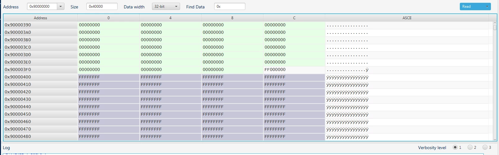

I used disco board stm32f769i in external flash application and it works well then I used the same microcontroller type with another external flash module  MT25QL256 and the written data is corrupted .
I think it is configuration problem so what the principle configuration should I review?
and is there any flashing algorithm code for MT25QL256 IC ?

There might be some BSP code for the Micron/ST parts.
I think the 512Mbit​ is more popular.
You might be able to use or repurpose some of the other loaders, but you'd need to be using the same pin configurations.
Writing loaders is a bit of a task​.

I used the same pin configuration but when reading data it seems like this some data burnt and other not
is there any clock or mode configuration need to be updated
