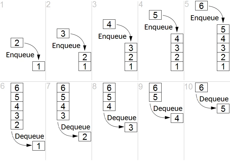

Fifo_queue
https://en.wikipedia.org/wiki/FIFO_(computing_and_electronics)
