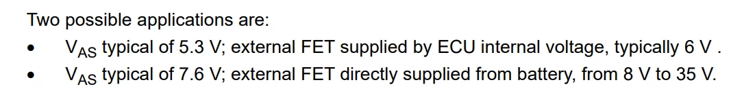

   I can't get my L9663 SPI working. My understanding is that any 32-bit data I send to MOSI will return a 32-bit data from MISO. However, I am not getting any response; MISO remains low the entire time.
    I am now using a QFP32 general adapter board to solder the L9663, so I want to use the minimum connections to get the SPI on the L9663 to work. According to the manual, only VB and VDD power supplies are needed to make the SPI work. Are there any other connections that could affect SPI communication?
  Now I am planning layout a PCB to solder and include some filter capacitors. Here's my plan. Can anyone help to check if it's complete design (at least the SPI will working well).
   VB=VAS=12V,VDD=5V
 GND1-GND2-DGND connect together
TM,CLKIN tied to GND
VASSUP tied to GND
BH1,BH2 tied to VB
100 nf capactor between VINTD and DGND
100nf capacitor between VDD and DGND
2.2uf//100nf between VB and GND1

No reply and I am answering to myself. It's working by the minimum configuration. I can read write the register and work out the crc3 tools by going through other's post.
Here comes a new problem. My sensor is going to be supplied @ 10V , but VAS overvoltage monitor setting in L9663 is lower. So the 9.6v appeared at PSI port but VAS_OV bit was set. I set VAS_EN=0,VAS_SEL=1.
I wonder how to set the register to increase the VAS overvoltage monitor threshold?
Thanks,

I just looked at ds L96xx , but :
So set the 7,6V and use it with your sensor.
What sensor ? (If only works on 10V , need other supply or chip.)

        Thank you for your reply. The sensor is NXP FXLS93230. It's programming mode requires at least 9V for entry, so for now it's just sufficient. And even if the vas overvoltage bit is set,it's still working well.
      My question is whether it's possible to achieve a higher voltage using a different configuration.
