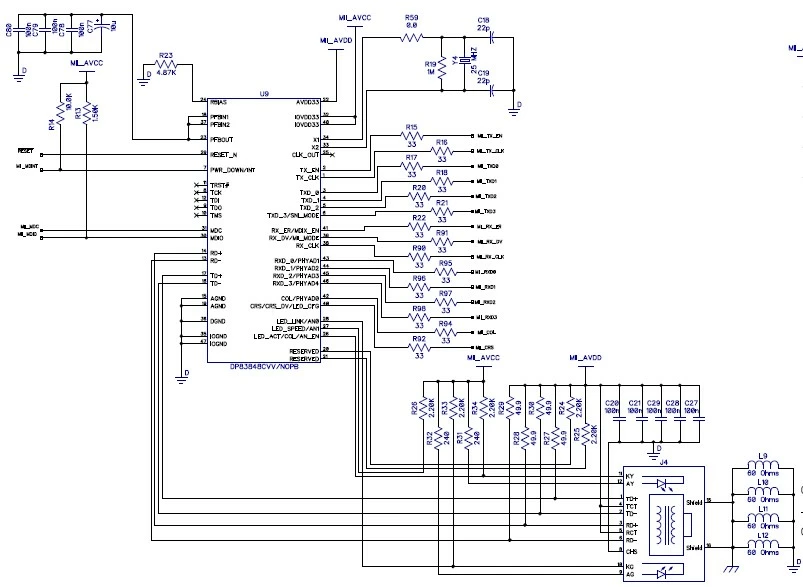

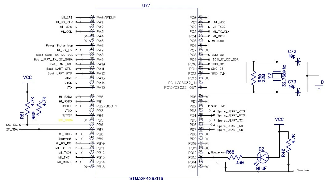

The board I am using has a STM32F429ZIT6 connected to a DP83848 PHY
The STM32429I-EVAL was used as a reference to the custom board. Different CPU pins were used due to the use of a STM32429ZI processor. Interrupt pin goes directly to the processor instead of to an expansion chip.
The hardware is connected MII.

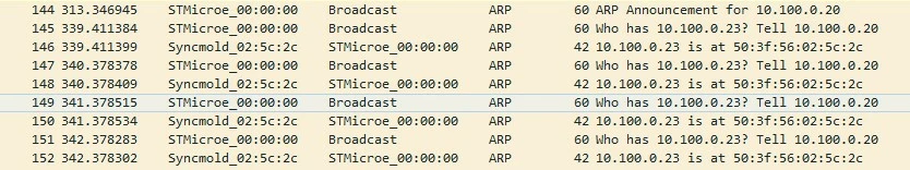

When I press the switch to start the TCP transmission, I do not get past the ARP.
WireShark Results example:
60 ARP announcement for 10.100.0.20
60 Who has 10.100.0.23? Tell 10.100.0.20
42 10.100.0.23 is at 50:3f:56:02:5c:2c

    0693W00000Bb4iAQAR.jpg0693W00000Bb4i5QAB.jpgI wanted to add the Ethernet Portion of the schematic.
    Also the Wireshark Image.

    I found a solution to my problem.
    R98 which is connected to the MII_RXD3 line was a 4.7K Resistor not a 33 ohm resistor.
    After changing that resister to a 33 Ohm the Ethernet started communicating.
