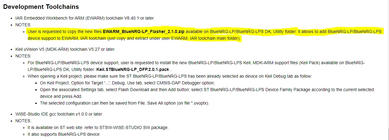

    If BlueNRG-LP is not supported by your IAR version, a Add-on pack is available on SDK (Utility folder)
    You may refer to below extract from SDK release note :

    C:\Program Files (x86)\IAR Systems\Embedded Workbench 8.4
    Is this the folder right for EWARM_BlueNRG-LP_Flasher_2.0.0 ?
    Sebastien DENOUAL
    February 25, 2022
    Yes : it should be the correct folder. This is your IAR installation folder.
    EWARM_BlueNRG-LP_Flasher_2.0.0 is a Add-on for IAR.
    It uses same folder hierarchies ad architecture as IAR installation folder.
