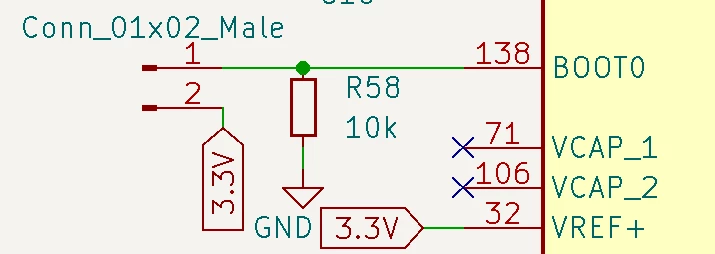

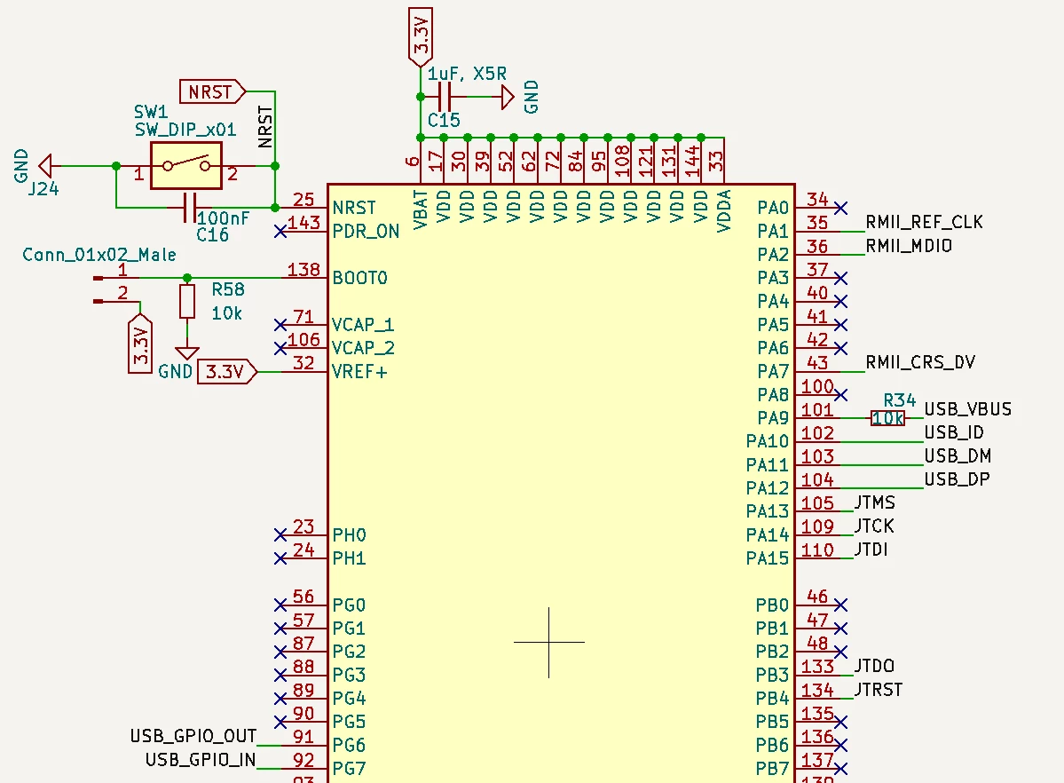

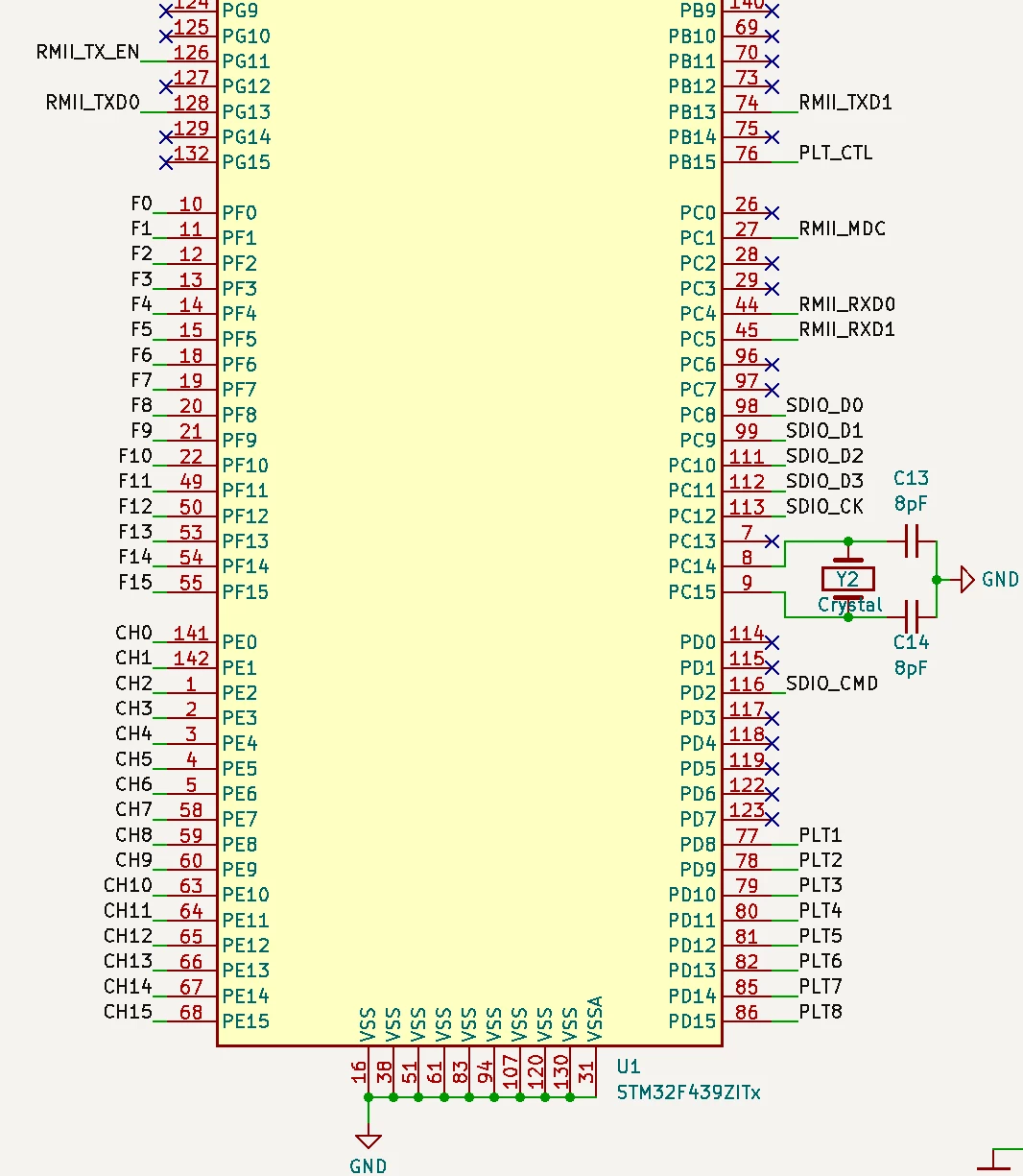

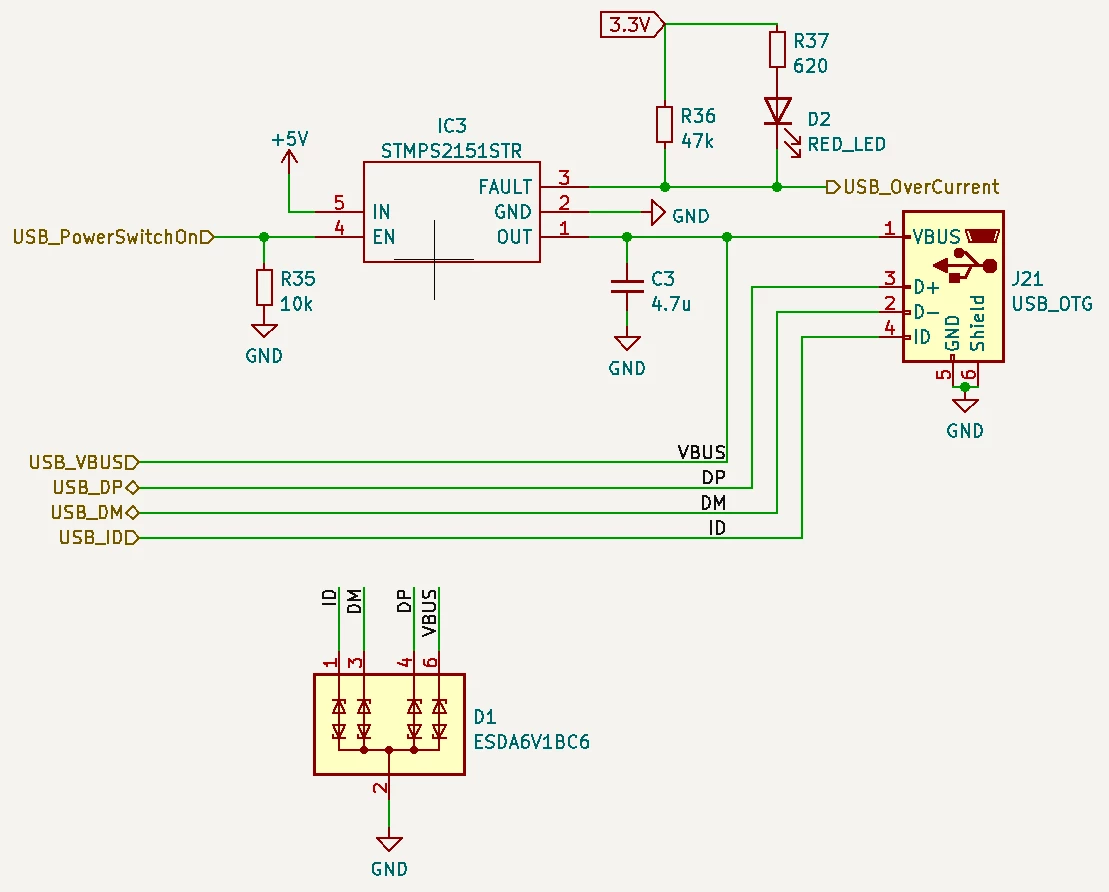

I tried to replicate the usb part of NUCLEO-F439ZI dev board to a project, without success.
I'm using vbus to power supply the MCU, through a voltage regulator.
For the MCU I'm using the stm32f427, not the 39, as in the development board, but they seemed compatible with my project features.
When I connect the board to my laptop via USB, the overcurrent led turns on, and my operating system (ubuntu) does not detect any new USB device.
If I connect boot0 to VCC, the command lsusb in ubuntu takes some seconds to respond.
Can you please give me some suggestions?
Thank you in advance

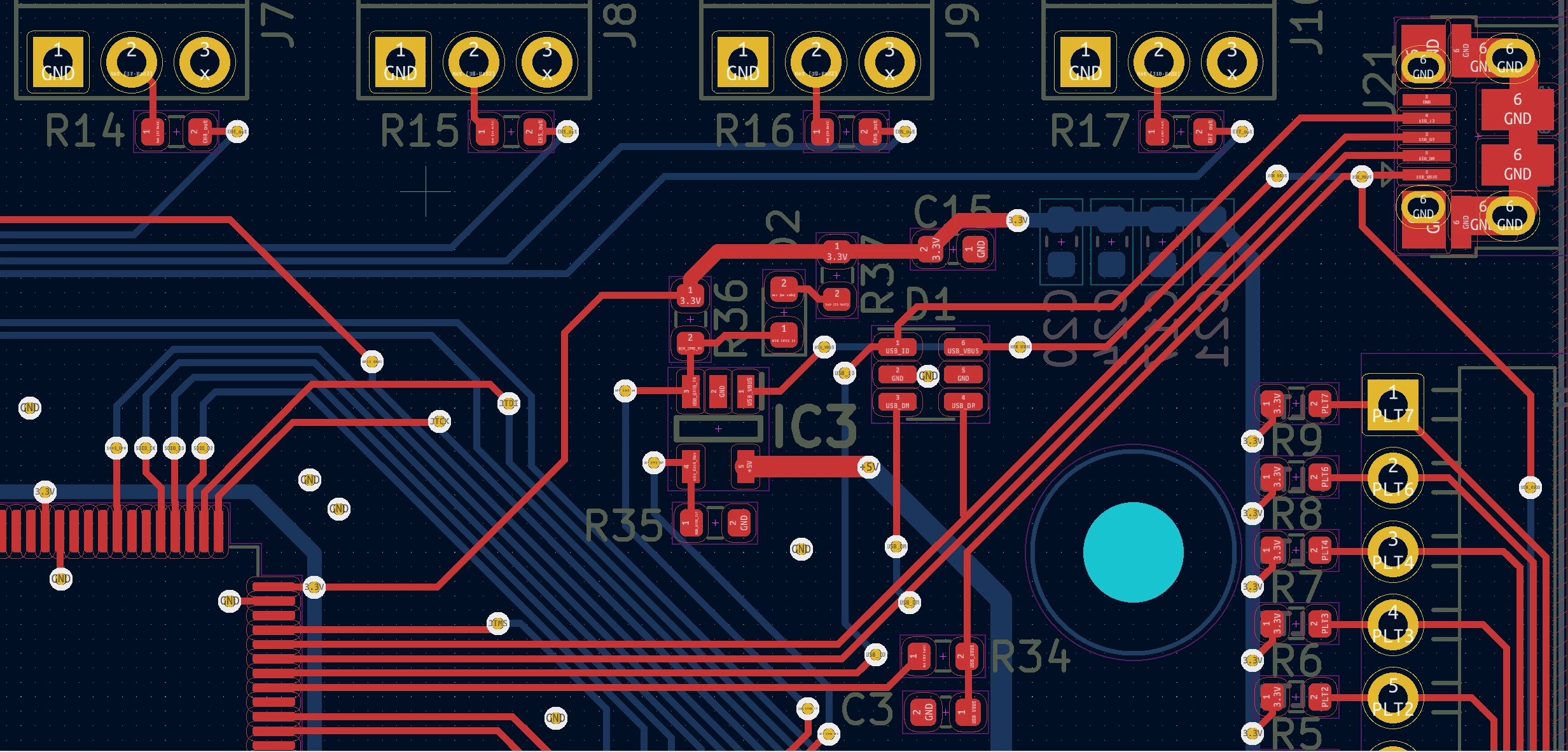

    MM..1
    Jan 24, 2023 7:36 PM UTC
    Your J21 usb con is faultly connected, too USB data lines need wire as diferential pair on pcb.
    FabioVasconcelos
    Jan 25, 2023 10:20 AM UTC
    Hello @MM..1​,
    What do you mean by a faulty connection?

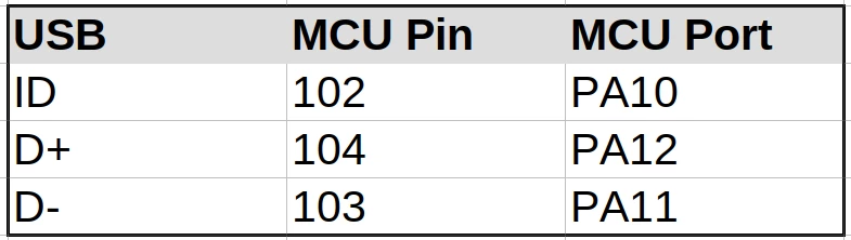

    The data lines are differential, and according to kicad calculator they have ~100Ω (Hope is it not the cause).
    I also have 5V in my voltage regulator, so it seems that the power lines are correct, then are connected according with the table below:
    MM..1
    Jan 25, 2023 11:19 AM UTC
    GND pin is open
    FabioVasconcelos
    Jan 25, 2023 3:15 PM UTC
    I figure that the overcurrent led turns on because of boot0 is connected to 3.3V, when I change boot0 to gnd, the led turns off. I will need it later, but for now, I will not take that for the equation.
    I desolder the IC3 because you are right I will not need it, thank you. But stills not working, the PC does not detect the board.
    Another thing that I realize is that programming by jtag through stlink v3, if I supply the board via USB, everything works fine and I flash the board without a problem, using an external 5V power supply, it's not programming. VUSB and external power supply go directly to a voltage regulator ( 5->3.3V) to supply everything. The only thing that changes is PA9 pin, which receives VUSB.

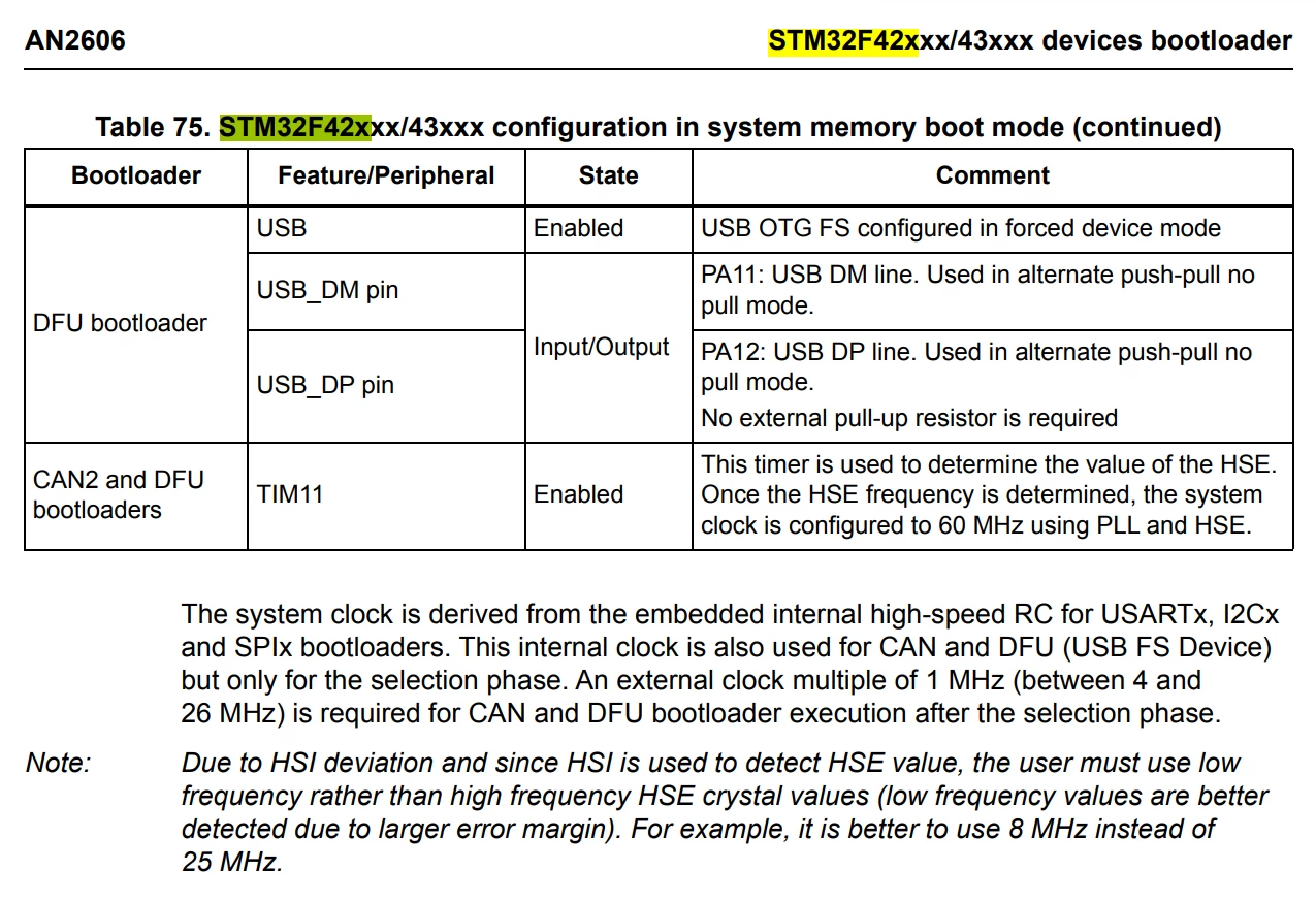

    MM..1
    Jan 25, 2023 4:16 PM UTC
    Your board need firmware loaded for detect on PC. Isnt based on you pin connection.
    And for use DFU detection is defined in AN2606 plus
    FabioVasconcelos
    Jan 31, 2023 3:58 PM UTC
    Hello @MM..1​
    I have PA11 and PA12 correctly connected, I hope but dfu is not working.
    Maybe the first line means something? USB OTG FS configured in forced device. What does this mean?
    My boot0 connection:
    I really apreciate your effort. Thank you!

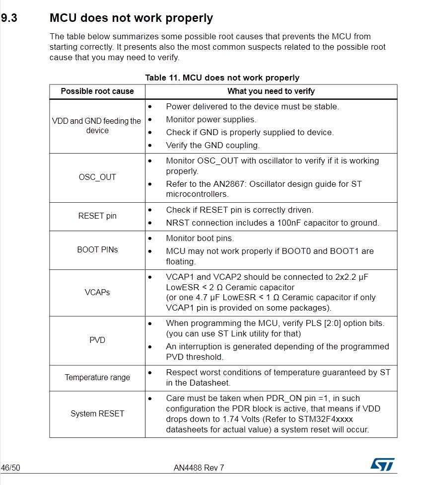

    Chris1
    Jan 31, 2023 4:55 PM UTC
    Is there actually nothing connected to the VCAP pins as it appears above?
    That would be a problem...

    FabioVasconcelos
    Feb 28, 2023 2:33 PM UTC
    I figured it out.
    I'm missing a crystal in PH0 and PH1, not it's working!
    Thank you all!
