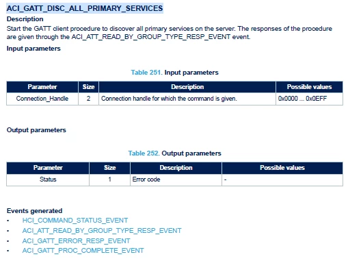

I am using BlueNRG1. My setup consists of a peripheral and controller. I am having issues using the aci_gatt_disc_all_primary_services() function. I input the connection handle received from hci_le_connection_complete_event. Yet, I get an error of 0x

    Hi @LCata.1​ ,
    Could you please confirm if error is happening on server or client side ?
    0x46 means "not allowed". Usually this error is raised because API is not called at right moment.
    Just in case : Avoid to call this API (aci_gatt_disc_all_primary_services) inside hci_le_connection_complete_event() to avoid reentrance.
    Is there any disconnection in teh meantime ? (disconnection_complete_event)
    May you share extract of code ?
    Regards,
    Sebastien.

    I am suppose to check disconnection_complete_event as well? I haven't looked at it since it wasn't mentioned here (see image).0693W00000Kc4rKQAR.png

    Hi @LCata.1​ ,
    Yes, this disconnetcion_complete_event inform you about disconnection ( whatever server or client side - it also gives you reason code for disconnection)
    I'm not saying it is root cause but If a disconnection happens for any reason, there is a risk you are calling aci_gatt_disc_all_primary_services with invalid connection handle (because of disconnetcion)
    Regards,
    Sebastien.
