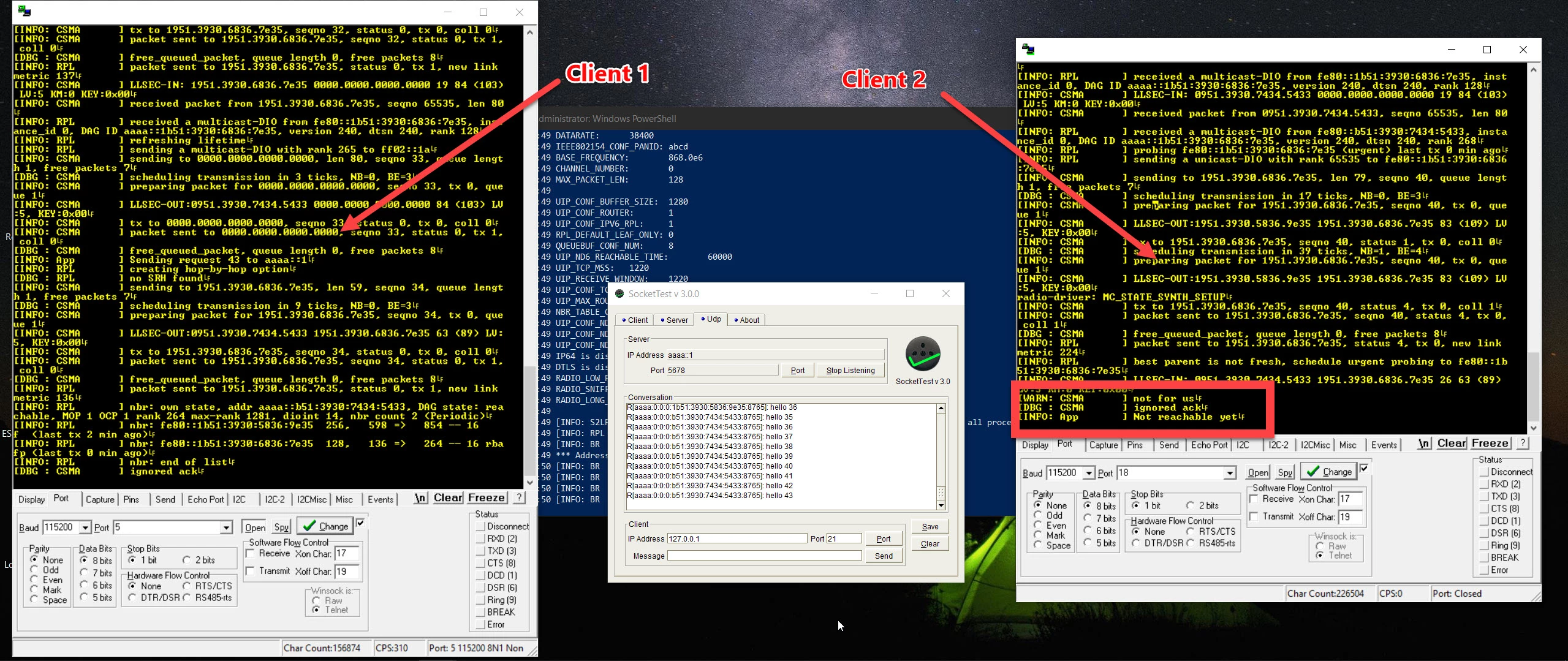

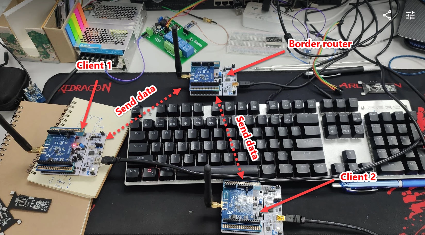

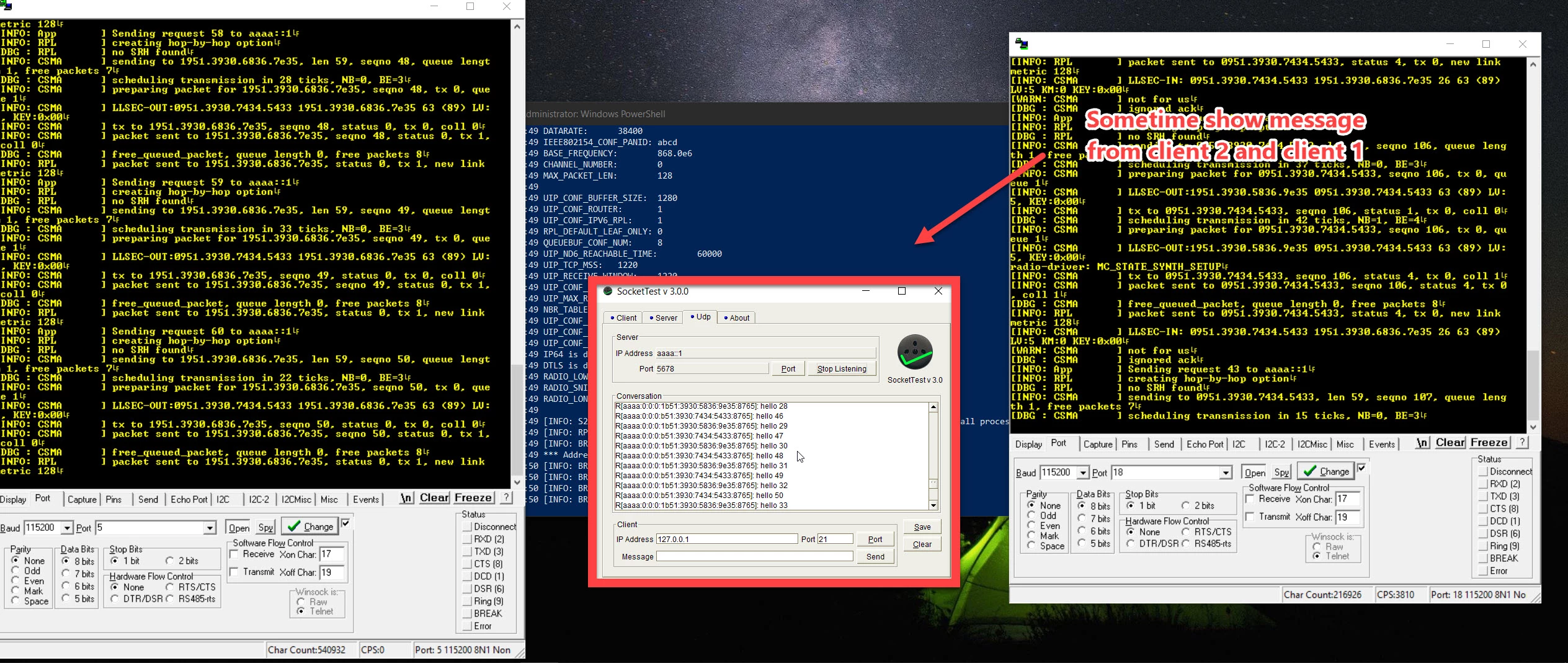

Jan 28, 2021 4:45 AM UTC
Hello @MGREL​ ;
Thank you for your reply.
I am try this your solution. My network is not mesh tropology. show photo below
0693W000007CyFrQAK.jpgThis photo. Client 2 should send the data to Client 1 then Client1 send the data from Client 2 to Border router.
0693W000007CyG6QAK.jpgThis photo to show message client 1.
Could you please advice me to make mesh tropology with S2-LP ( Client mesh example )?
Thank you,
Best regards.
MGREL
Jan 28, 2021 12:07 PM UTC
if you configured both the UDP Clients to send data to "aaaa::1" address it is normal that you see the UDP messages on the UDP Server running on the host, this regardless the fact that the network topology is star or mesh.
To try to setup a mesh (multi-hop) you can try to setup a linear topology with the second node in the radio range of only the first node:
BR ------- NODE1 -]------ NODE2
Where ']' is the end of BR's radio range.
Not sure if I replied to your question...

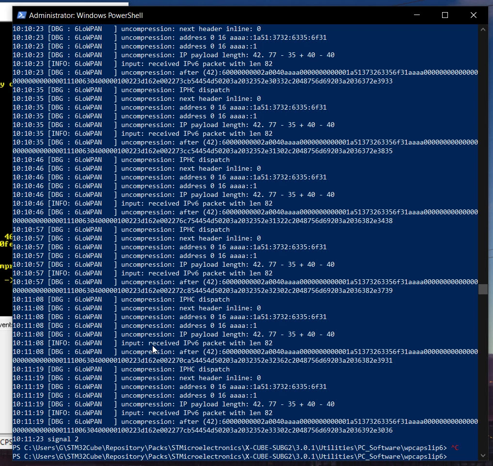

To disable Link Layer security and so see packets in clear in Wireshark using the Serial Sniffer you can recompile UDP Client / Server / Border Router after changing
#define LLSEC802154_CONF_ENABLED 1
to
#define LLSEC802154_CONF_ENABLED 0
in contiki-conf.h file
BR

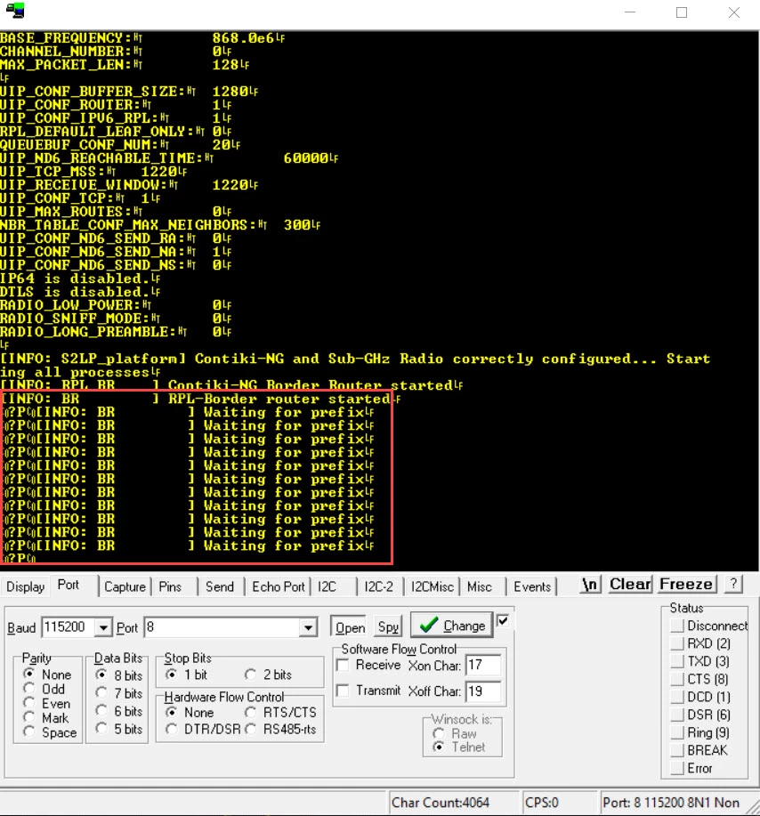

Feb 9, 2021 3:17 AM UTC
Hello, @MGREL​ ;
Thank you for your replay.
I try your advice. It's working. I would like to show a photo below
0693W000007ERalQAG.jpg I would like to turn off the message from Border Router is "Waiting for prefix" and I would like to show the message from client at serial terminal. Show a photo below
0693W000007ERaqQAG.jpg Could you please advice me the solution for this issue ?
Thank you,
Best regards.

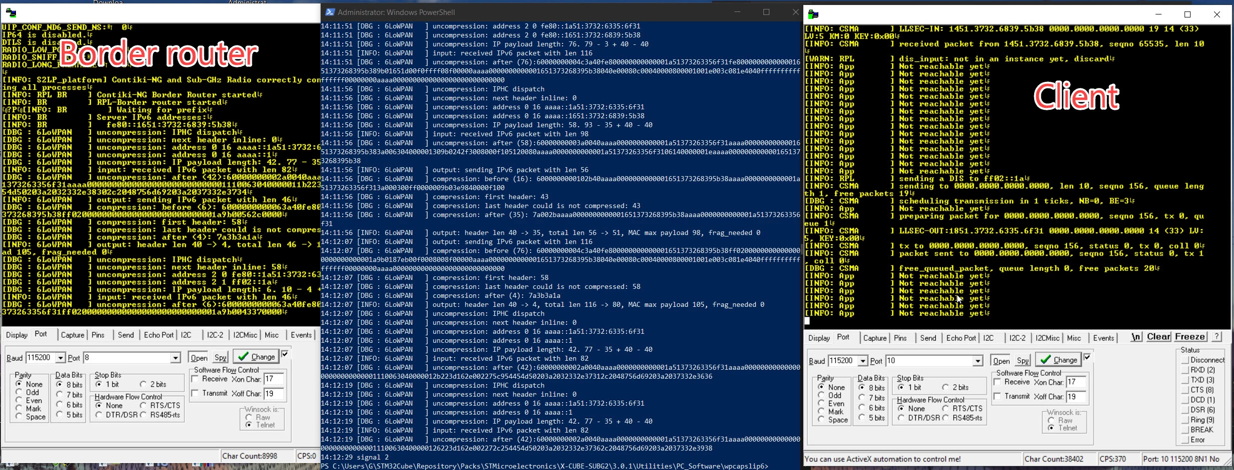

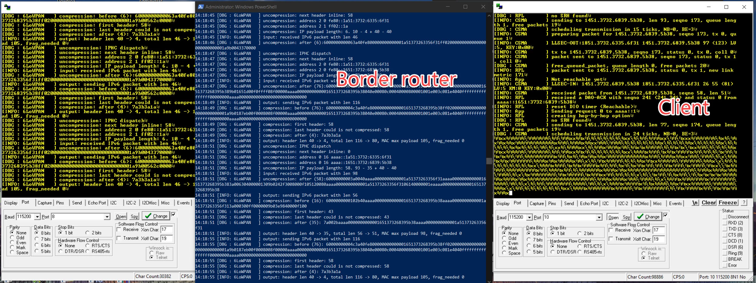

Feb 10, 2021 7:20 AM UTC
Hello, @MGREL​ ;
I would like to show a photo. The first time will not work when I open terminal for Border router and terminal for Client.
When I use PowerShell. It's working. I would like to know how I can setup all without PowerShell. Show a photo below
Could you please advice me this issue?
Thank you,
Best regards.
MGREL
Feb 11, 2021 9:07 AM UTC
Hello, I am not sure if I have understood the problem. The Border Router can work only if connected to tunslip6/wpcapslip6 because it needs
  • the parameters to form the network (network prefix and host address)
  • the user space tunnel application to connect to the host protocol stack
so if you use a terminal you just see Border router output that is basically SLIP6 packets (and debug messages if you enable them)
If you don't need to send UDP data to the host PC you can use the UDP Server firmware that implements also the RPL root.
