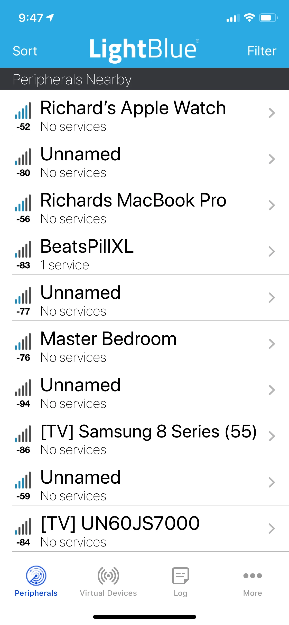

How to get a detailed scan response
Hi am using the BlueNRG-LP. I am a master/client and want to discover local devices and then decide who to connect to ... I am able to get the advertising data from local devices including the BT addr, RSSI etc. But I want to get the Scan response data from them so I can get more information - such as name etc... So think along the lines of LightBlue or similar BLE Apps that get as much info as possible without needing to connect.
How is this achieved in this stack - the documentation is very thin!

Thanks Winfred. I have done as requested but I am definitely not seeing all the same information as I get with an app such as LightBlue or nRFConnect. On the apps I see device names and service information (before they even connect). I also do not get an event type of 0x1B.
I also note that the code in BLE_SensorDemo_Central uses an abstraction layer such as Master_Init() which I am unable to see, we dont get source code. Should I drop all that and just use the ACI commands instead?

In lightblue i see.... the attached image
Can you explain why I am getting nothing like this?

@Winfred LU​ Do you have any ideas? I am active scanning and barely get any scan responses. But clearly they are out there because my android and iOS phone pick them up with various apps. How do I go about getting faster support from ST? Turnaround is so slow

Could you please try to set SCAN_TYPE to 1 ?
It is defined In master_config.h line 132, where 0 means passive scan and 1 means active scan.
The devDiscParam variable In deviceScanConfiguration() is supposed to used for aci_gap_set_scan_configuration() ACI, as far as i understand.
Then, try to handle them in hci_le_extended_advertising_report_event() event callback.
It is true that the libmaster_library has wrapped lower layer ACIs into an abstraction layer for user's easier usage. I don't have access to the source code either.
Use the ACIs directly when you need a full control or specific customization.
Please refer to the programming manual in the DK, section 3.3.2, for the ACI example about the scan responses.
