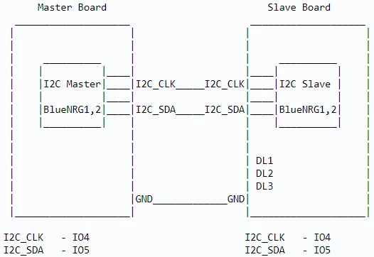

Winfred LU
Jul 25, 2019 2:29 AM UTC
The I2C slave polling sample project in DK works well for me,
with the followed scenario:
