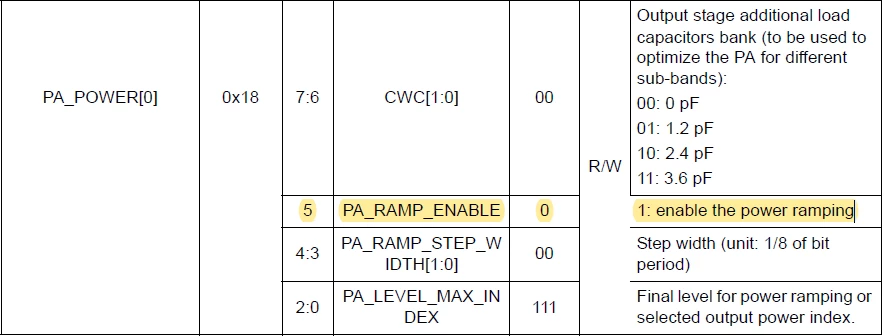

  1. It seems to me that PA_POWER[1] (address 0x17) is configured since cindex is 0(address=PA_POWER8_BASE+7-cIndex;).
  2. Power ramping is not enabled, as you see in this function void SpiritRadioSetPALevelMaxIndex(uint8_t cIndex) at this expression SpiritSpiReadRegisters(PA_POWER0_BASE, 1, &tempRegValue); I verified bit 5 was not 1.

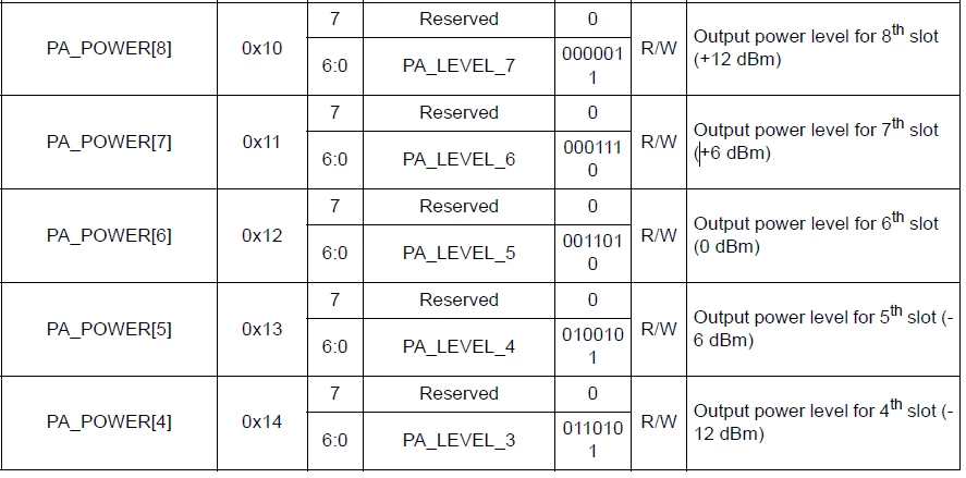

  1. 0690X00000AtFdwQAF.pngFrom above table in last column what does that +12dBm, +6dBm... mean? Are those maximum power output in respective slots or power output during register reset?
2. Which slots/PA_POWER[x]/PA_LEVEL_x should I choose for maximum power output?
I am working on STM32CubeExpansion_SUBG1_V3.1.1 SDK and want my nodes to be configured at maximum output, so that data can reach from roof to inside lab. If you need more info, let me know. Thanks again for your help.
