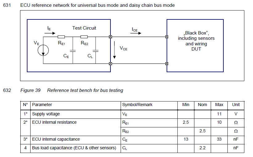

How do I determine the pi filter component values for the L9663 transceiver?
  • March 11, 2020
  • 0 replies
  • 807 views
I am looking into using this part: https://www.st.com/content/ccc/resource/technical/document/datasheet/b4/f8/3b/f7/8e/d8/4e/c4/DM00249556.pdf/files/DM00249556.pdf/jcr:content/translations/en.DM00249556.pdf and was wondering how I can come up with the values for those pi filter components shown in the block diagram (figure 4, page 14). It says to reference the PSI5 standard but I want to confirm I am looking at the correct thing. Is this the part within the specification I should be referring to?
