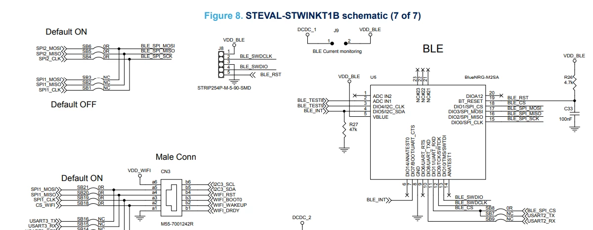

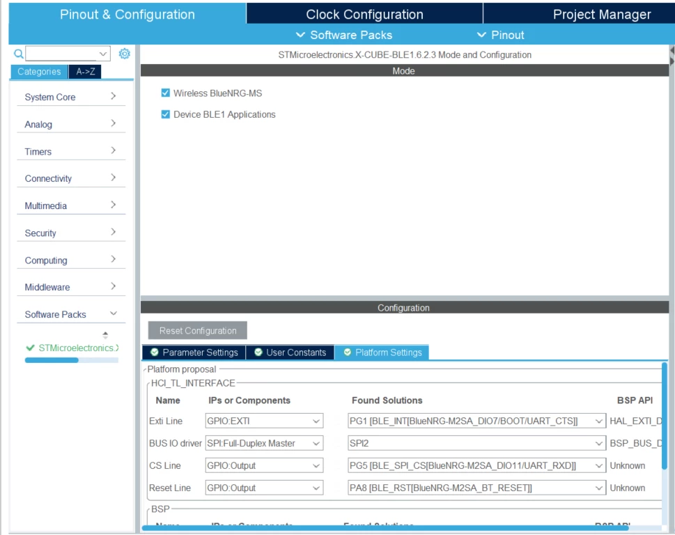

I am trying to use the BLE (SPBTLE-1S chip) on my STWIN to send acceleration data, and receive some parameters. My first idea was to use a template from X-Cube-BLE1 with the following configuration :
  • HCI_TL : Basic
  • HCI_TL_Interface : UserBoard
  • Application : SensorDemoBLE
According to the schematics, I need to use the SPI2 to communicate with SPBTLE-1S.
0693W00000VOMahQAH.pngMy CubeIDE configuration is the following:
0693W00000VOMa3QAH.pngUnfortunately after flashing, I can't communicate with the BLE, the void MX_BlueNRG_MS_Init(void) failed because of the function aci_hal_read_config_data(CONFIG_DATA_RANDOM_ADDRESS, BDADDR_SIZE, &bdaddr_len_out, bdaddr). The printf indicate "Static address not well formed".
Edit 03/11/2022:
  • getBlueNRGVersion give FW_Version = 0 why ?
  • The function tBleStatus aci_hal_read_config_data(uint8_t offset, uint16_t data_len, uint8_t *data_len_out_p, uint8_t *data) return BLE_STATUS_TIMEOUT
