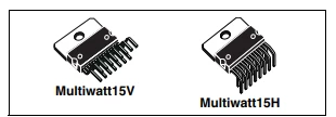

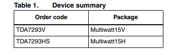

How can I know if my IC is TDA7293 or TDA7293V?

straight pins or bended ?
Peter BENSCH
July 20, 2023
Even if the TDA7293HS is still listed in the data sheet, it is not and was not a regularly available product. Your device is therefore most likely the TDA7293V.
Hope that helps?
