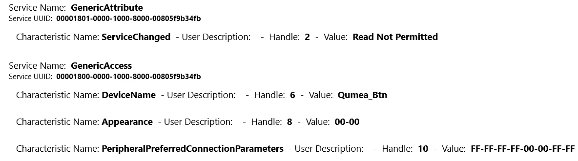

Hello together
I'm currently working on a project with the Bluenrg-2 232 Chip.
The device is battery powered and in order to notify the user, when the battery is low, I would like to read out the battery level.
For that, I thought, I could use the default battery service. But I cannot find it when I scan for the service.
I only find the GenericAttribute and GenericAccess Service.
Is the battery service not implemented on this Chip? Or do I have to activate it manually somewhere?
Many thanks for any response.
