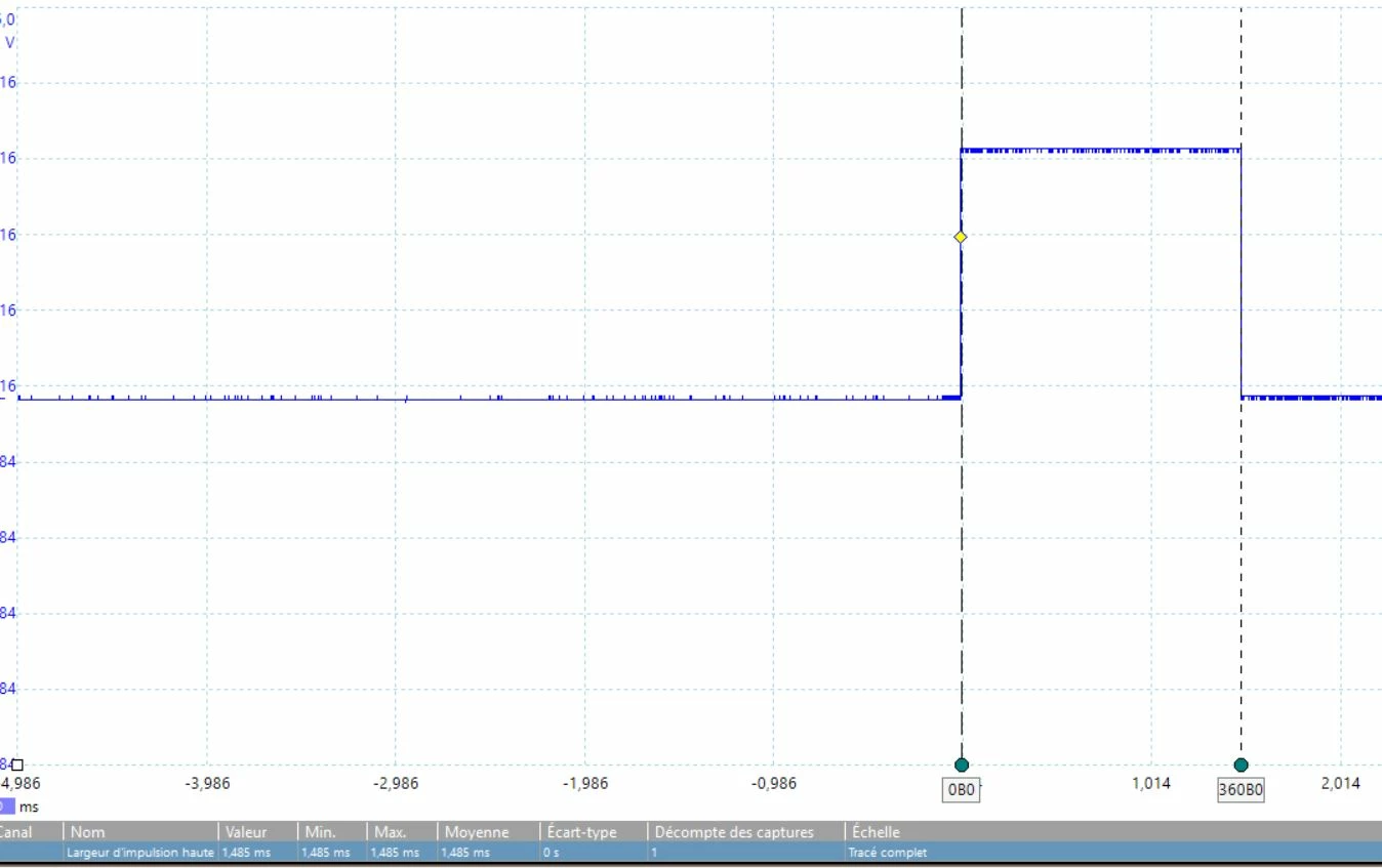

Please check SPI connection and SDN.

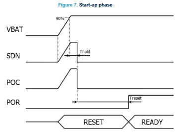

During start-up, SDN must be kept high for at least 1 ms.
Please refer to datasheet, Figure 7:
https://www.st.com/resource/en/datasheet/s2-lp.pdf

During start-up, SDN was kept high for 1,485 ms as mentioned on below measurement:

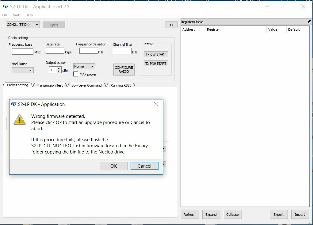

When i try to connect with S2-LP DK tools to my board (based on STM32L0xx) i have below problem:
Any proposal for the problem please?

Hi Mohamed,
Could you please firstly check if SPI reading 1byte from S2LP register works?
Best Regards,
Winfred

Hi Winifred,
My firmware is already sending data to another node with S2LP. I have only a problem with S2LP DK tools.
