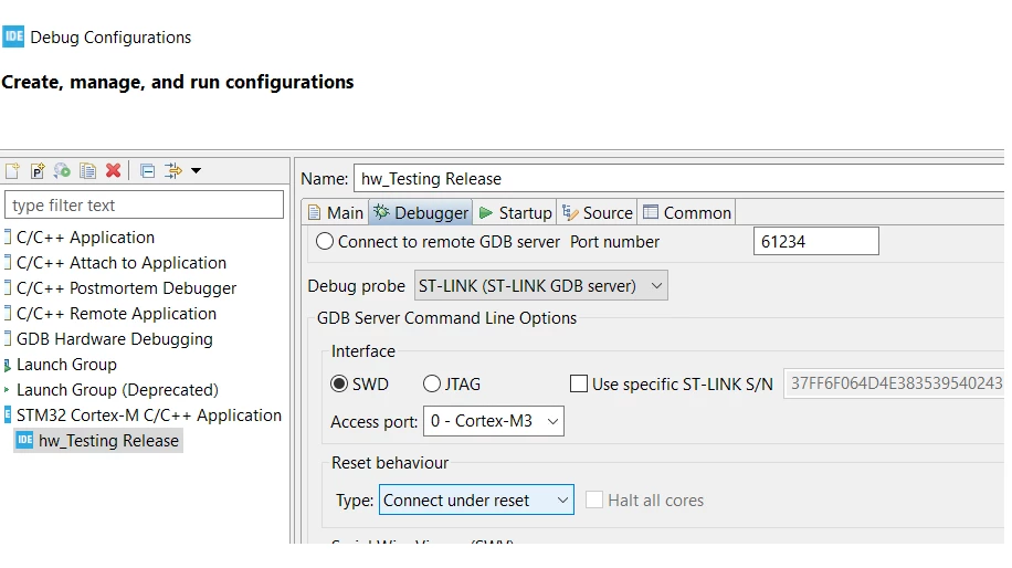

Hi, we have designed our own product which is using STM32F103 mcu . we are unable to download / debug using STlink/V2. i can download when i choose connect under reset option in debugger configuration but unable to run in debug mode. help on this

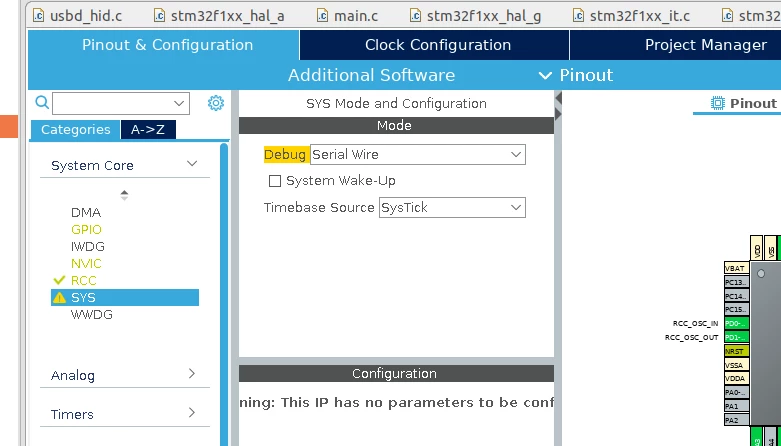

    Yep, cubemx by default disable swd in this mcu. You have to enable it. Check screenshot.
    Regenerate code. Download it under reset once.​

    Hi, Im able to run in debug mode after i configured the debug setting as serial wire but still i have to set debug configuration--> reset behaviour --> connect under reset . If i set it as none i'm unable to download.
    Why i'm getting issues if i follow default settings?

    Connect under reset only works if you connect the reset pin properly, and it works.
    oeliks
    December 30, 2019
    First flash with new settings should be​ under reset. Next flashing should work without reset pin connected.

    Yes, now its working fine.
