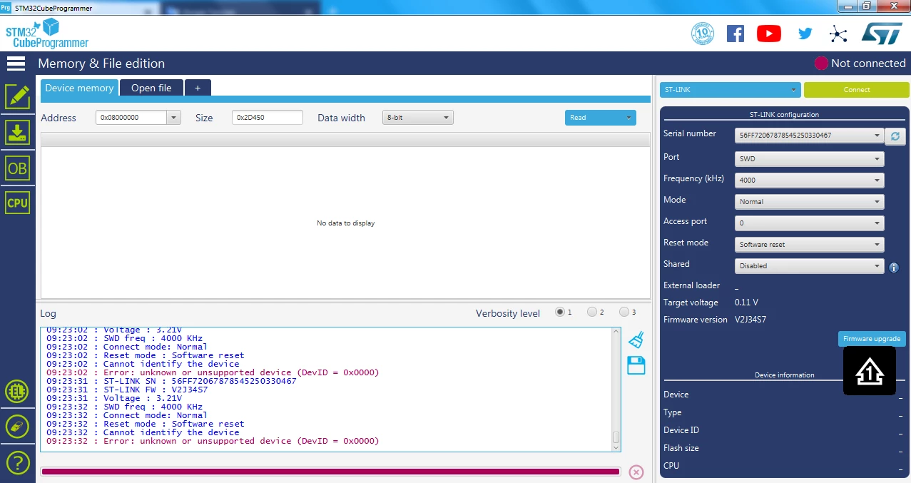

Hi everyone, I need some help with ST-LINK/V2.
  • March 25, 2020
  • 5 replies
  • 2211 views
I am using this ST-LINK/V2 for programming bluetooth chip BGM11S through SWD.
This bluetooth chip has SWD-pins for communication.
But ST-LINK/V2 can not connect with this bluetooth chip, there is an error: "Unknown or unsupported device (DevID = 0x0000)".
The screenshot is under, do you guys have any idea about this? Thank you very much from Germany.

    The St Software obvious does not work with none-St chips. You can use the StlinkV2 with pyocd, openocd or bl*ackm*g*c with the pc-stlinkv2 platform.
    B.t.w. to my knowledge, StlinkV3 actively denies cooperation with non-ST parts. An it is more picky to connect to ST parts.

    The problem is the toolchain, and it's support of debug pods.
    Segger has a JLink firmware for ST-Links, available for free download. That should work with other toolchains and MCUs as well.

    Hi Uwe, hi Ozone. Thank you for your replies.
    @Ozone​ Which JLink firmware do you mean? I have tried with JLink Commander, but it does not work. Thank you in advance.
