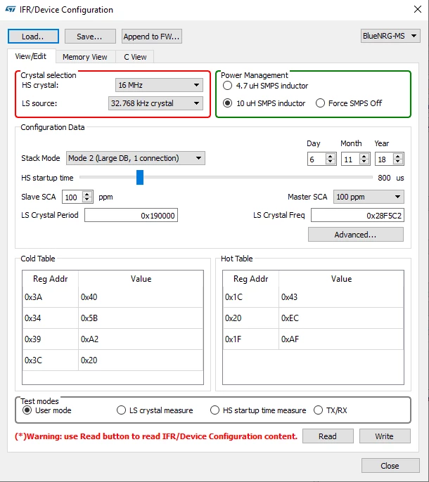

Hello, I have a Bluenrg-ms connected to a STM32 for the Bluetooth connectivity. How can I set the Bluenrg to use either a 32MHz or 16MHz external crystall oscillator? Thank you very much

    Please use BlueNRG GUI, "menu | Tool | IFR/Device Configuration" to config accordingly.
    https://www.st.com/content/st_com/en/products/embedded-software/wireless-connectivity-software/stsw-bnrgui.html

    I too am trying to configure my board's IFR, but I am using the B-L475E-IOT01A (DISCOVERY), for which there is not an option in IFR/Device Configuration. Any idea how I can make this work?

    SPBTLE-RF module is based on BlueNRG-MS chip.
    Usually there is no need to modify IFR configurations for the Discovery kit.
