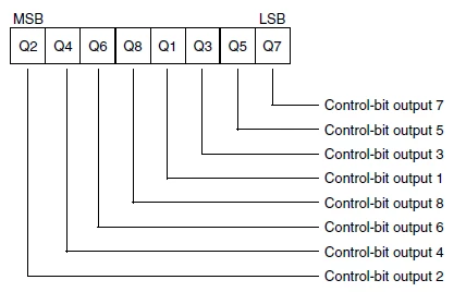

for L9826 chip datasheet, what is the Status-bit stated in "Table 7. Diagnostic Table for outputs 1 to 8 in SPI controlled mode" and for this bit is in which register, and is it is send to the micro controller through the SDO?

    In the the latest L9826 datasheet (rev 10), Diagnostic Table for outputs 1 to 8 in SPI controlled mode is in Table 9.
    https://www.st.com/resource/en/datasheet/l9826.pdf
    The following (number of the Figures or Tables) will be based on datasheet rev 10.
    Please refer to Figure 5 for the output control register structure:
    These bits can be configured through the serial interface (SPI).
    In addition, Output 1 and 2 can be configured also with parallel pins - NON1 and NON2.
    To configure thru SPI, control data are transmitted to SDI (NOT SDO) through the micro controller. The bits shall be transmitted at every CLK falling edge.
