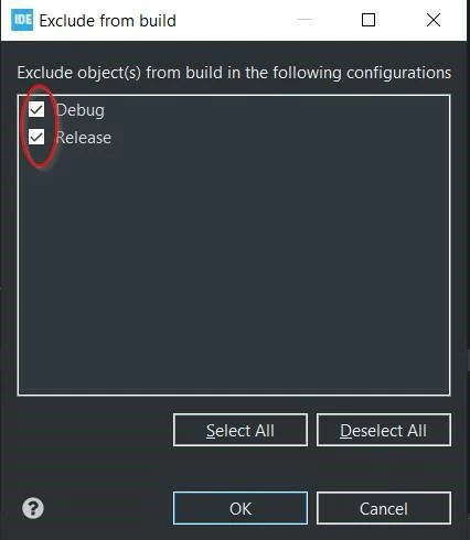

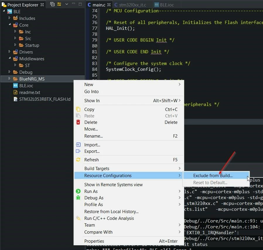

error undefined reference to MX_BlueNRG_MS_init and Process.
I created new project with 32L152Discovery and additional Software STM X-CUBE-BLE1 5.0.0;
After build I have a error "undefined reference to MX_BlueNRG_MS_init and Process.
But in my project there are all files.

SJazo.1
Visitor II
Jul 5, 2020 2:34 AM UTC
Apparently there is a bug when CubeMX or CubeIDE generates the BlueNRG code, the source folder is excluded from compilation by default.
You just need to include it and rebuild your project:
