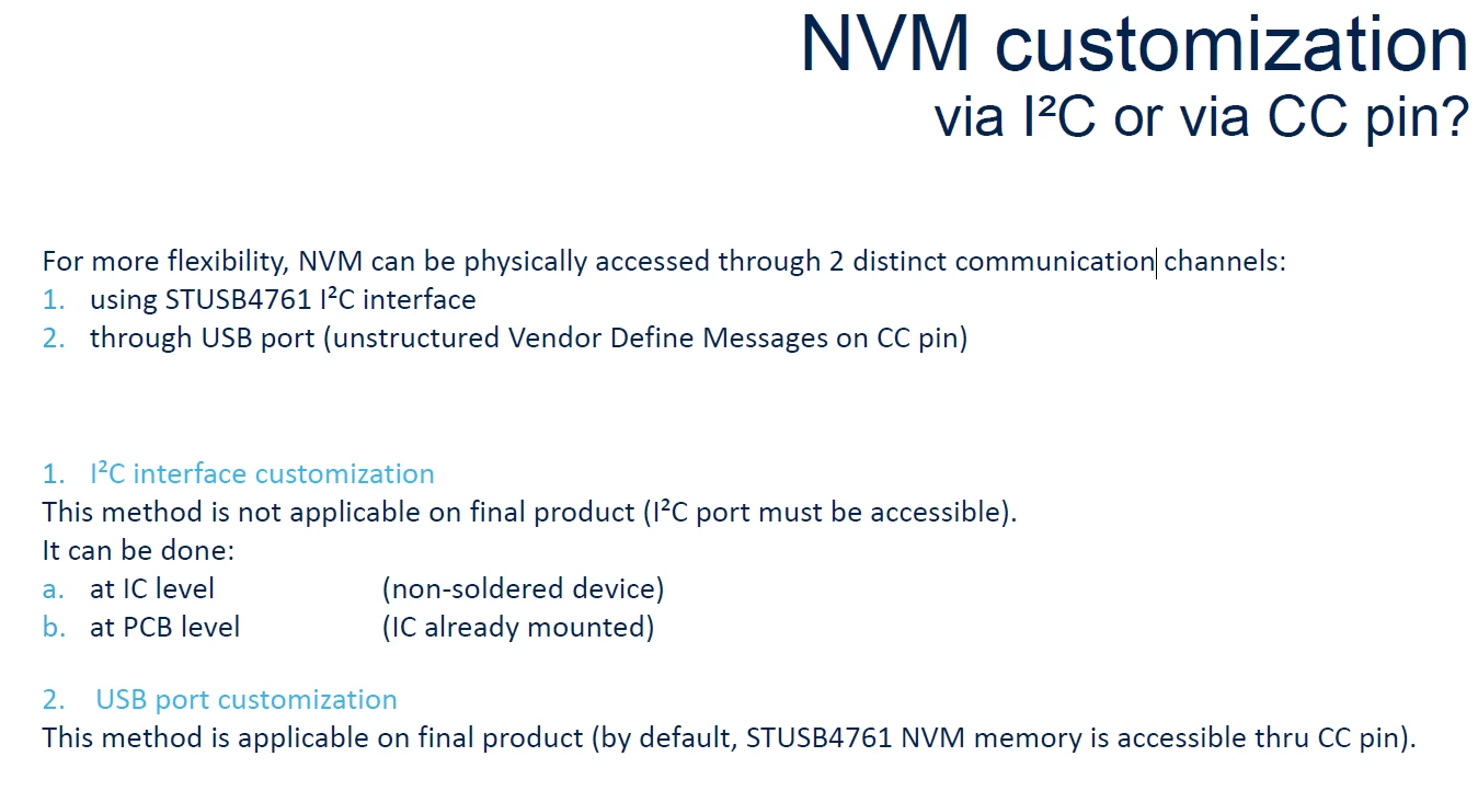

    Nucleo board is required to customize the NVM through I2C
    EVAL-SCS003V1 is required to customize the NVM through CC pin. Mentioned in the datasheet.0693W00000FBa5sQAD.pngWe could select any one of these based on user requirement.
    Hope you got my query.
    thanks

    The GUI shall also work without any electrical connection to STUSB4761 IC, allowing user to, for example, customize NVM settings and export to a file.
    The warning of "No STUSB detected" is showed when performing operations that require STUSB4761 IC physically, such as "Read IC" or "Flash IC".
