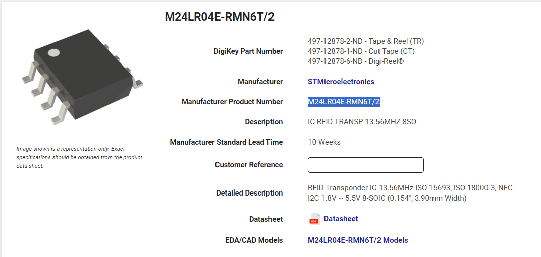

Does RFID Transponder M24LR04E-RMN6T/2 work with Mifare Desfire
Hi.
Please can someone tell me whether Part No: M24LR04E-RMN6T/2 (RFID Transponder) is able to communicate with MiFare Desfire ?
Application will be a custom designed PCB to be used as part of Prepaid payment system
Thanks

Welcome @CW1, to the community!
First of all a note: M24LR04 are already on NRND (Not Recommended for New Design).
Furthermore, MIFARE® DESFire® complies with ISO14443, M24LR04 to ISO15693 and is therefore not suitable.

NFC tags comply with either ISO14443 or ISO15693, not both.
Yes, M24LRxx has been replaced by ST25DVxx, but it is also ISO15693. The only Dynamic Tags still available with ISO14443 are M24SR02, M24SR04, M24SR16 and M24SR64.
However, you should note that MIFARE Desfire uses a proprietary protocol, the details of which are probably only communicated by NXP under NDA. STMicroelectronics cannot help you with this and cannot provide any software for MIFARE Desfire.
