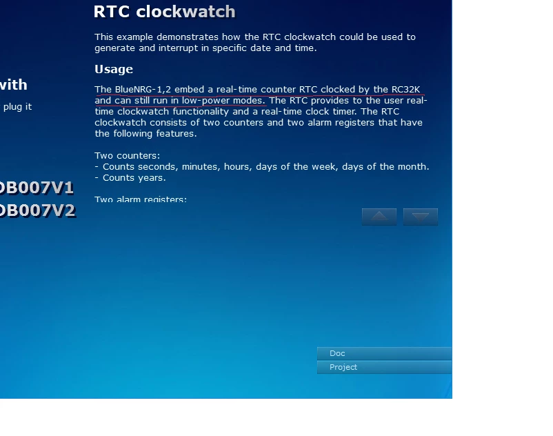

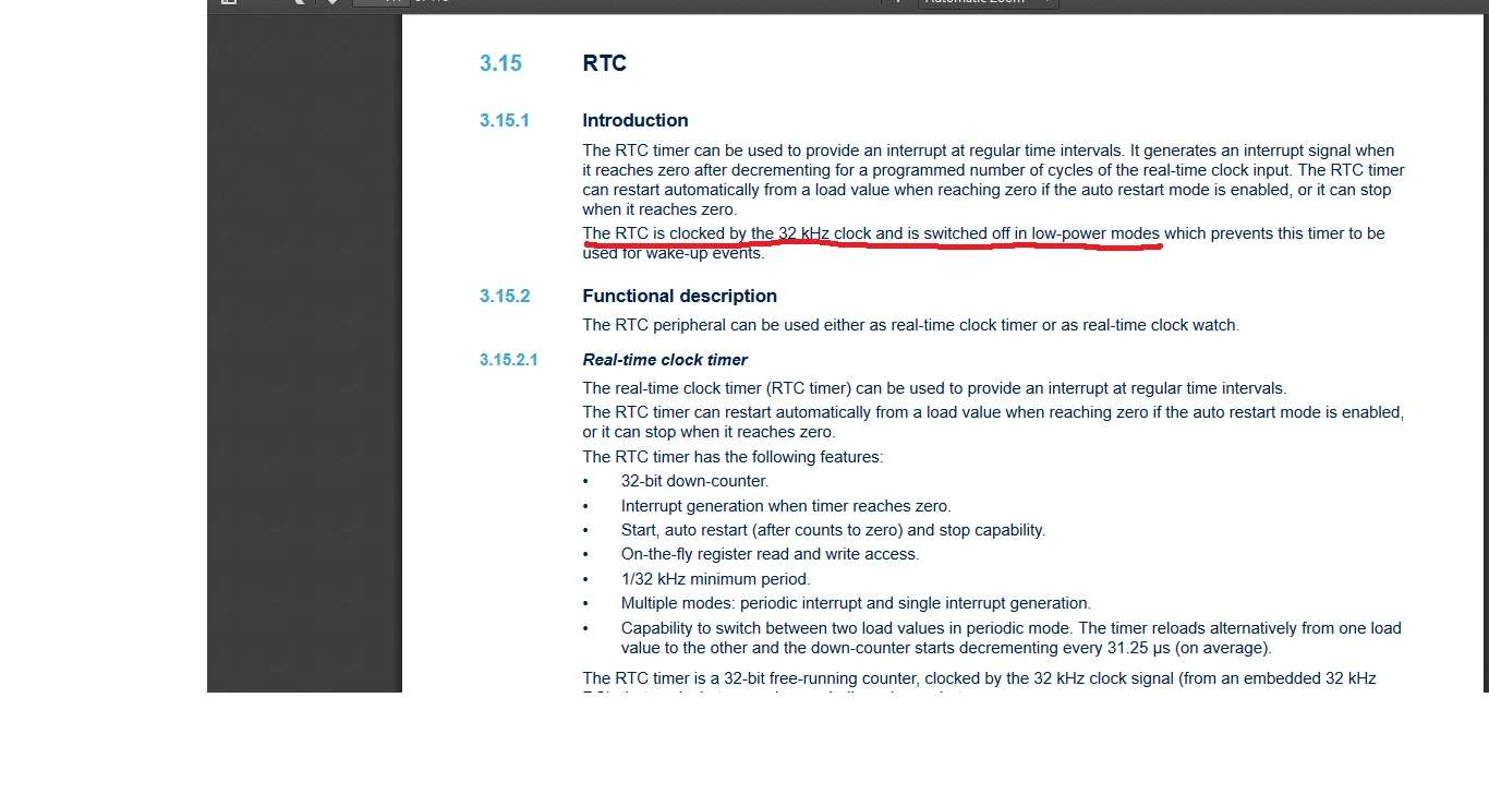

Does in bluenrg2 RTC working in sleep mode?
  • February 4, 2019
  • 1 reply
  • 1142 views
In datasheet said:0690X000006DMiqQAG.png
But in BlueNRG-1 Navigator i found this:
    1 reply
