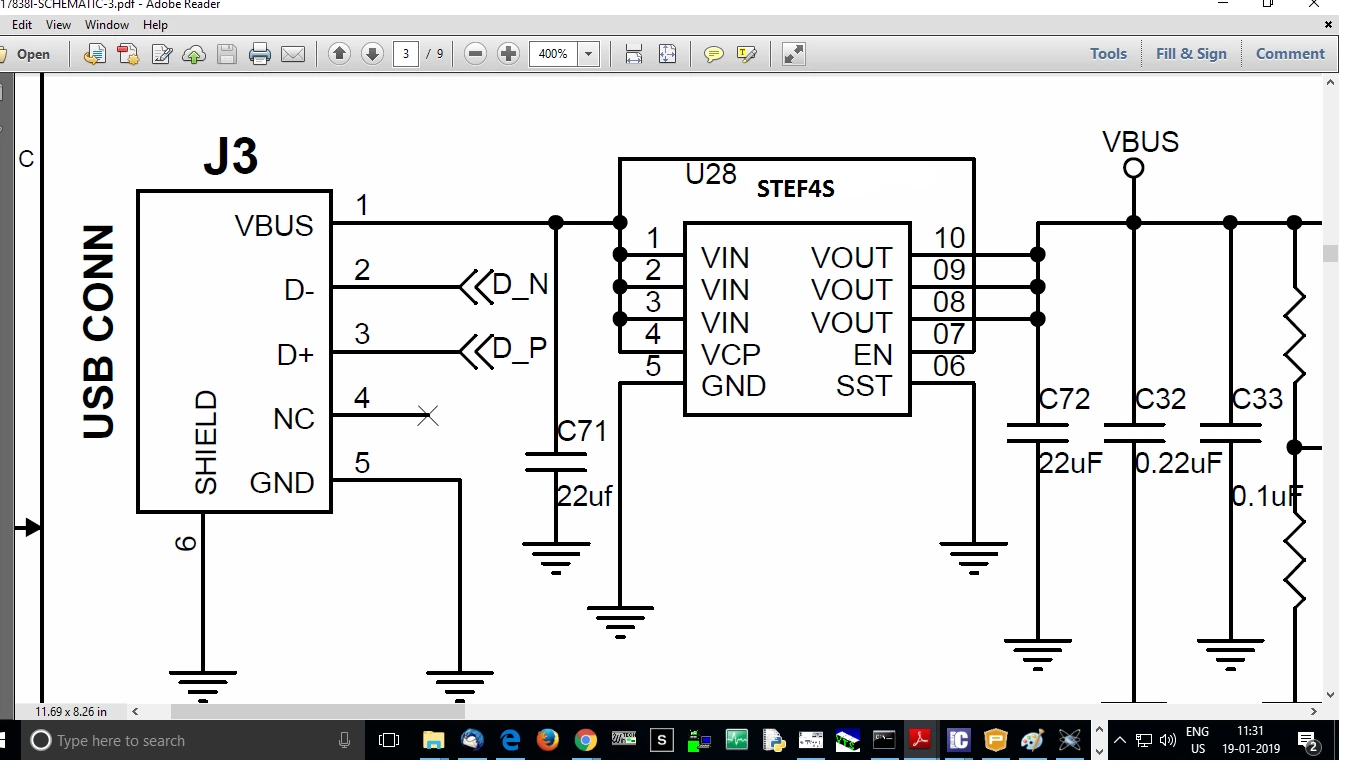

Dear Sir/Madam, Actually i have bought stef4s fuse ic from element14 and used it in our power circuit.Problem is that i'm not able to get output from this fuse.

I will attach you the circuit.It was just made looking at the datasheet and its pin configurations.Please go through the circuit and let me know for any modifications.Thank you.
