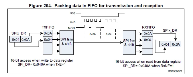

waclawek.jan
Feb 13, 2020 8:21 PM UTC
> SPI1->DR = value;
This starts a 16-bit transfer, see "Data packing" in SPI chapter of RM and here on forum. Is this what you wanted?
Generally, you want to observe the pins using logic analyzer and compare the observed waveforms with those given in the sensor's datasheet.

waclawek.jan
Feb 13, 2020 9:33 PM UTC
No, I'm talking about Tx. Have you read the "Data packing" section in SPI chapter in RM and have you looked it up here on the forum?
Have you observed the waveforms?

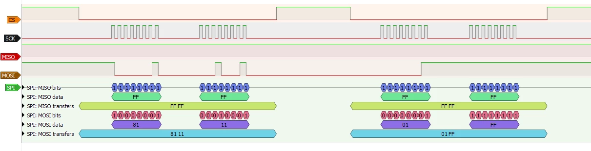

So, I've gone back through the documentation for the MCU and the slave device (AMIS-30543) and got a logic analyzer. I've updated the code some and I think I've narrowed down where the error may lay. Here is a screen grab of the logic analyzer results and updated code.
The slave device's documentation is here. It states it must receive a command+address byte followed by an empty byte in order for one of its registers to be read.
https://www.pololu.com/file/0J869/AMIS-30543-D.pdf
It looks like I'm correctly sending 8 bits of data to the slave device, but am still receiving blank data in return.

waclawek.jan
waclawek.janBest answer
Feb 24, 2020 10:13 AM UTC
At this point, I don't know. As it's the AMIS chip which does not answer to what appears to be a correct sequence, it's then either incorrect wiring, bad solder joints, or faulty chip...
SNeub
Feb 24, 2020 2:37 PM UTC
I'm very happy to report it is working now; soldering the joints did the trick. I soldered the pins now instead of simply laying the chip on top of the breakout pins (I thought the contact was sufficient, but was clearly wrong in that assessment). The stepper motor now spins as instructed.
I did notice that I'm unable to flash the MCU while the power supply is connected to the stepper motor and the motor will continue spinning when the MCU is unplugged from the computer (I was powering the MCU via USB for development). The LD2 LED is also faintly illuminated, for some reason.
