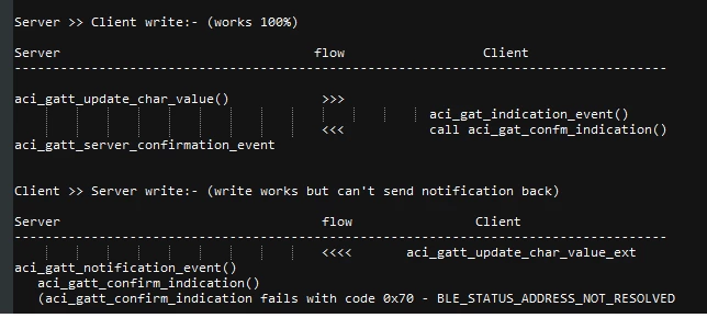

I'm trying to :-
A> use one characteristic that Server can use to write data to Client with indication
B> use same characteristic so that Client can send data to Server with indication
the characteristic is set up as follows aci_gatt_add_char(....CHAR_PROP_READ|CHAR_PROP_INDICATE|CHAR_PROP_WRITE on both Client and Server
I have achieved A> and works pretty well, however I'm having problems with B>
the problem is even though I can send easily send the data from Client to Server and Server is receiving the data in the aci_gatt_notification_event()
How can I achieve notification back? I'm happy to have the Client >> Server write on a separate Characteristic

I added CHAR_PROP_INDICATE so now have
aci_gatt_add_char(....CHAR_PROP_READ|CHAR_PROP_INDICATE|CHAR_PROP_WRITE|CHAR_PROP_INDICATE
but aci_gatt_notification_event() still doesn't get called on client.
Also, when server sends data to client, client receives data push on notification AND on indication which is not what I need.

nibbly78
nibbly78Author
Dec 5, 2019 10:58 AM UTC
Are you saying it's not possible to achieve what I'm asking for?
If not, then please please share with US how I can get some sort of acknowledgement on the CLIENT from the server that the server received the data.
