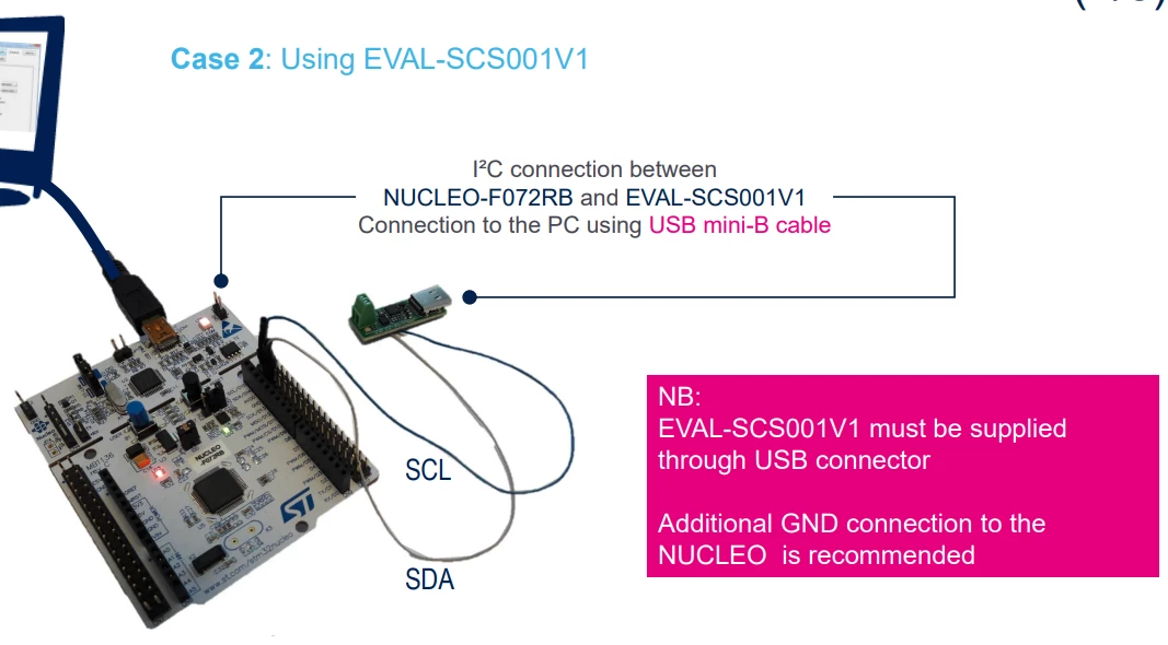

BHan.1
BHan.1Author
Jan 15, 2021 5:57 AM UTC
Hello Greg,
Thanks for the answer.
Just a follow-up question. When we do use the Nucleo boards to set STUSB4500, the STSW-STUSB002 guide picture shows only SCL and SDA connections to the Nucleo board.
0693W000007BRVuQAO.pngDoes "EVAL-SCS001V1 must be supplied through USB connector" mean I have to connect a separate 5V power supply to the STUSB4500 board or I have to jump power from the Nucleo board to the STUSB4500?
The information on the page is a little confusing.
Thank you
Winfred LU
Jan 18, 2021 3:36 AM UTC
Both ways shall work.
Supplying through USB connector means to supply Vdd with 5V from Vbus.
