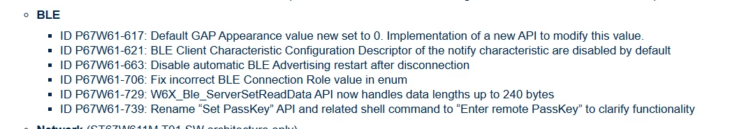

  1. GATT Read-Data Corruption: Any characteristic value set via AT+BLEGATTSRD that exceeds 23 bytes (the default ATT MTU payload boundary) gets systematically corrupted. A 32-bit little-endian length field is overwritten directly into the data buffer starting exactly at offset 23.
  2. Missing Notify Property & CCC Descriptor: When registering a characteristic with the Notify property enabled, the NCP's internal database (AT+BLEGATTSCHAR?) reflects the property correctly, but the exported GATT database exposed to the BLE client drops the Notify bit and completely omits the Client Characteristic Configuration Descriptor (0x2902).

Using the binary version 2.0.89 when there is a newer version 2.0.106 (and has been for some time), is not recommended. As in this case, I believe both issues were already solved with this release.

Oct 21, 2026 12:32 PM UTC
thank you for your help, it now works. At least my first point, that was important.
